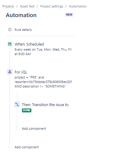

I would approach the solution with an automation like this

Many Thanks Phil - I believe the automation does work because it processes the tickets anyway but it just doesn't shut them which is the part not working. I asked the project lead to provide me with the process so I can have a look at the condition and check if this is met at all.
In which case you might need to add an additional action to set the resolution on the issue as well as transition it to the end status.
