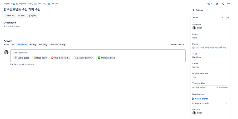

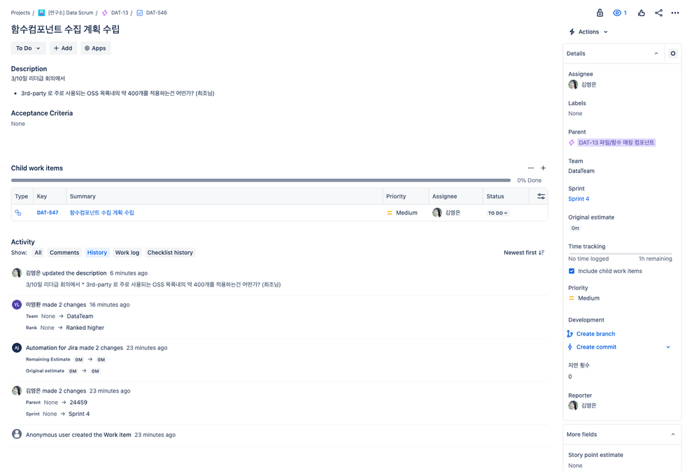

The result is success but Original Estimate did not change.
You can see Automation for Jira has set Original Estimate to 0m even when I set Original Estimate of subtask to 6h.
