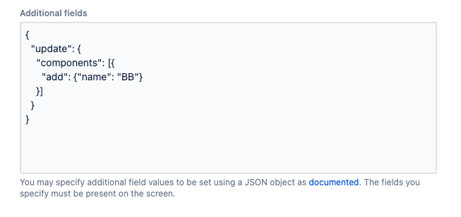

Just hoping for a quick answer here. - how do you format the JSON field in automation to add two different components?
My automation is based around an if/else condition: if component = AA, then add component BB. Else if the component field is empty, then add Components AA and BB.

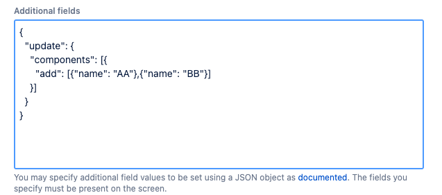

I have the JSON code for the single component aspect (which runs just fine), but not being familiar with JSON, I'm not sure how to properly format adding two. All of my attempts have yielded some sort of "error while parsing additional fields" so clearly I'm missing something. For reference, Here is my single-component JSON, and my latest attempt at the double-component

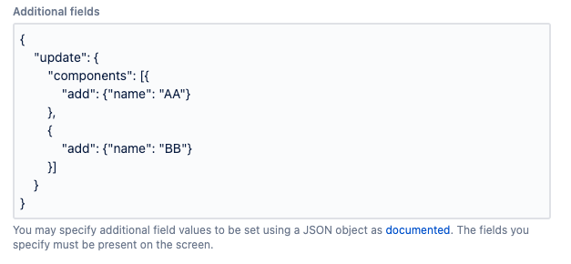

For those looking for an answer - I HAVE ONE!
Atlassian Support now has a chat option and I was able to have someone get me the correct formatting. Here's the code format if you need to add at least 2 components to an automation rule.
Not sure how to paste it in as actual code, but hope this helps!
