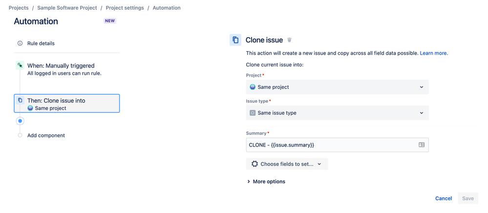

Walter Buggenhout
January 12, 2023
Hi @Ivan Andrieiev,
Create an automation rule with a manual trigger. As automation action, select clone issue and define the fields you want to copy.
You should be able to trigger that rule from an issue, by selecting the Automation rules link in the details panel of an issue you open.
Hope this helps!
