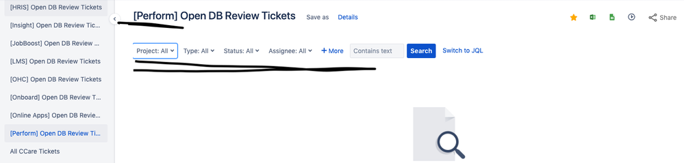

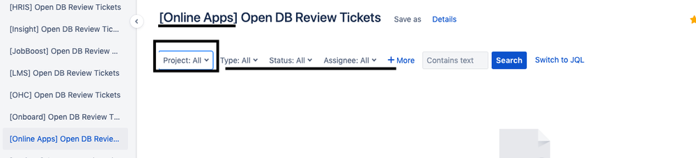

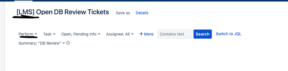

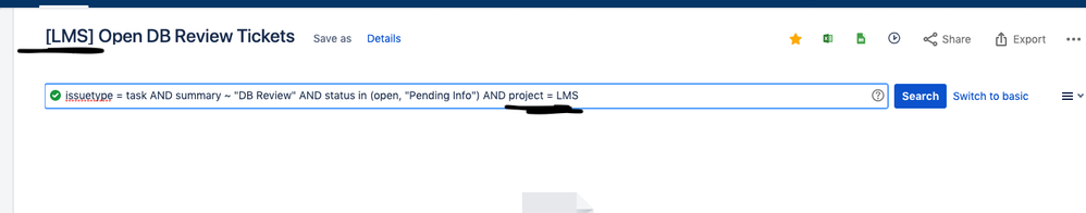

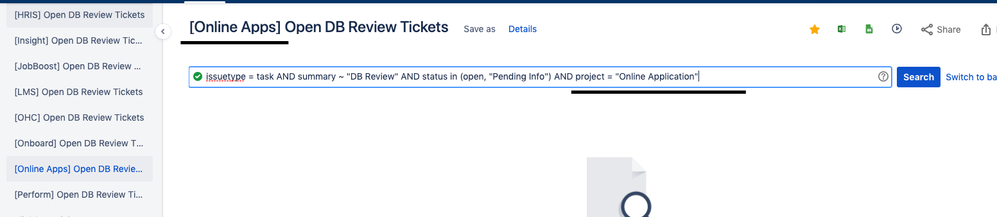

1. Go to my jira instance, click on any saved filter. See the results, look at search bar.
In basic mode it doesn't show the actual criteria for the search, click on advanced and see the correct JQL statement.
Click on another saved filter - see that basic search criteria doesn't update. Go to advanced and the JQL is correct
See screenshot in order of actions performed:LMS-incognito-advanced.pngLMS-incognito-shows Perform.pngperform-basic.pngperform-advanced.pngonlineapps-advanced.pngonlineapps filter - basic.png onlineapps-basic, then advanced, perform-advanced, then basic
