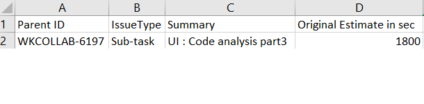

Am uploading all my subtask in an excel (csv)format . the issue am facing is that the original estimate is not shown in the subtasks its remains to 0m
sample file : upload task.png

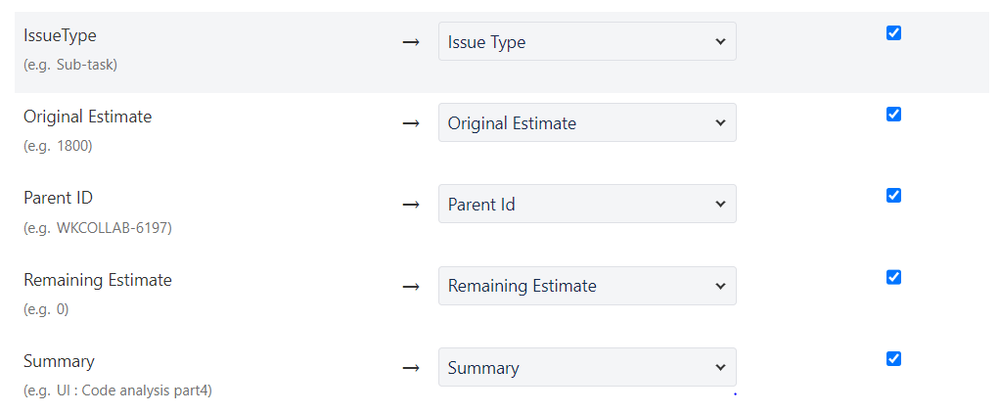

when uploading all the other field value are being reflected except for original estimate.

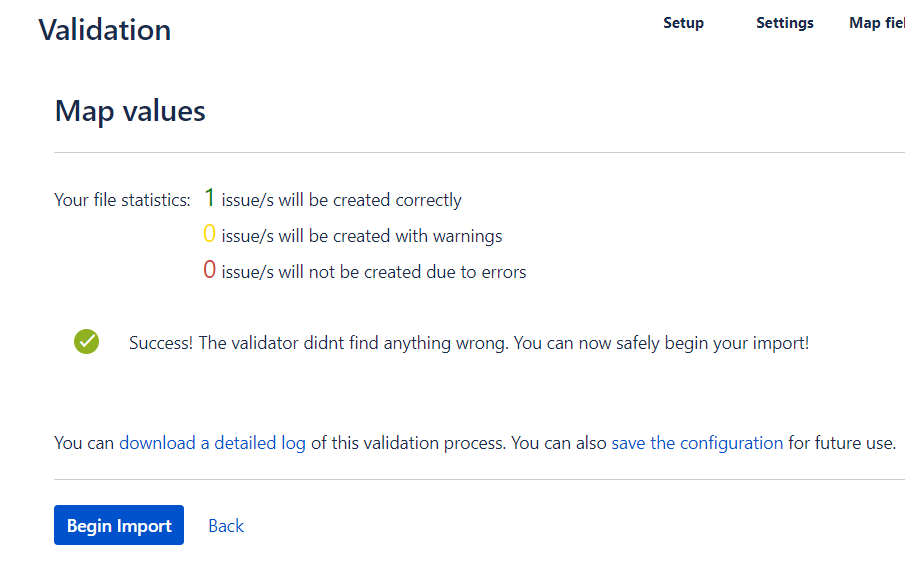

while doing the doing the verification test it's not showing any errors
