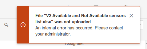

When I try to upload attachments of size 1MB it fails to upload and shows internal error occurred. please find my Atlassian logs and Catalina logs below.

Hi Thuvaragesh,
unfortunately the log snipped does not show anything related to the problem with uploading attachments. Those informational messages are more generic ones - nothing special to worry about.
In case you should not be able to identify a cause from logs I'd also suggest to investigate the underlying server's filesystem. Just to make sure there is no quota (file size restrictions, if you want so) set on operating system level. Although most probably not the case I'd also check for remaining disk space on the relevant partition (the one Jira tries to save the attachments to) and (although least probable) if the file system of the server is consistent.
