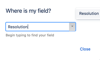

1. Click 'Edit' on your issue
2. Click 'Configure Fields' on the top right of the resulting pop up screen
3. Click on 'Where is my field' if you don't see Resolution in the field list
4. Type in 'Resolution'
5. Now scroll down to the 'Field Screen' section. There will be a message explaining that the Resolution field is not included in the screen configured for this issue. There will be a link to the Screen Configuration settings page. Click on that link.
6. Add the Resolution to the Screen Configuration page. Keep this page open (you will remove the new field from this configuration shortly).
7. Navigate back to your issue and click 'Edit'. Now you should see the Resolution field as an option. If it's still missing, you may need to select the Resolution Field in the 'Where is my field' dialog to see it (you also may want to try refreshing the browser). Screen Shot 2019-12-11 at 6.08.56 PM.png
8. Once you can see the field, update your resolution to the desired status. Click 'Update' to save.
9. Finally, return to the Screen Configuration page and hover over the Resolution field. Click 'remove' when it appears on the right.
This process essentially adds Resolution to the 'edit' screen temporarily. If you leave it on permanently, and it's a required field, you won't be able to move from Unresolved to another workflow phase.
Again, I think Atlassian/JIRA should come up with an easier way to edit the resolution on closed tickets, but this will help in a bind.

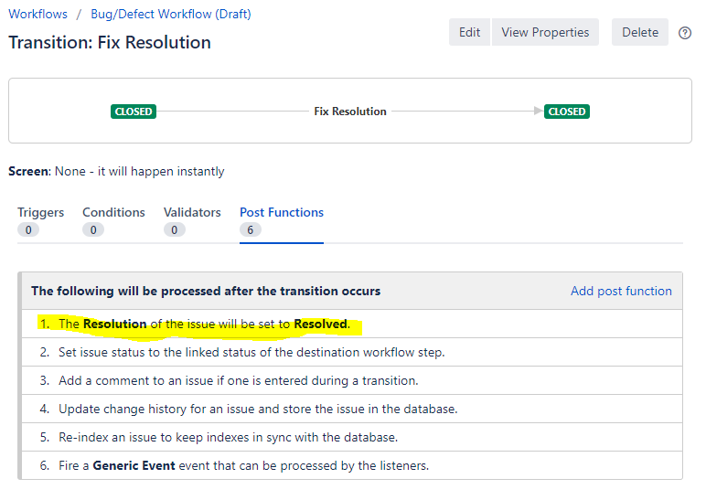

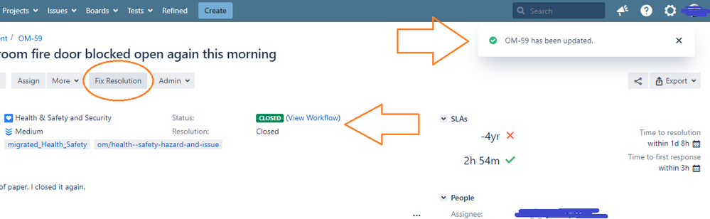

Ioannis D
October 21, 2021
Hello @Marzi Goodarzian and all,
I had the same issue and apparently the below solution worked for me:
  1. Bulk-edit the issues and apply an extra label, in order to remember which issues will be amended/touched.
    e.g. with label "jira_resolution_manually_set"
  2. Edit the related workflow to include one more transition, eg. "Fix Resolution"
    • From status Closed to status Closed
    • Add a post-function to update the resolution to the desired one.
      eg. "Resolved"
  3. Publish the workflow
  4. Test the new transition on a ticket or two
  5. Bulk edit the issues and apply this new transition
  6. Voila :-)
  7. Remove the new transition from the workflow
There are 2 drawbacks:
  1. The Updated date for all issues will be "touched" to the current date.
  2. You might need to amend a couple of workflows, if multiple projects and/or issue-types are affected.
You might find this solution a little bit simpler than the one suggested by @Nic Brough (Adaptavist). Or not :-)
Cheers,
-i.
