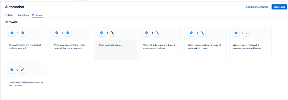

This is already created in the Automation library, if you go to the Project Settings and then click on Library:

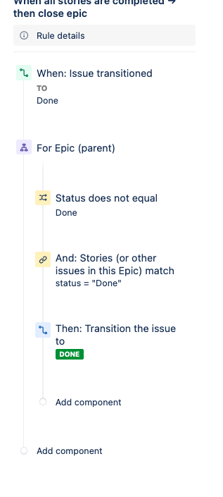

You'll see an option for When all stories are completed -> then close epic. See the screenshot below if you need to create it from scratch.
Does not work.
With legasy worked fine but with automation did not.
How to monitor the linked issues if changed to done automaticly change the parent request to done
Can you explain what is not working? Is it running into errors or is it not transitioning the parent issue?
