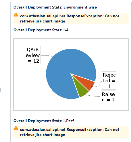

Since we upgraded from Jira 8.11 to 8.16 we are experiencing random issue reading Jira charts macro in a confluence page with following error, some charts will load and some wont. Refresh screen and some others may load and some which were loading may error
com.atlassian.sal.api.net.ResponseException: Can not retrieve jira chart image

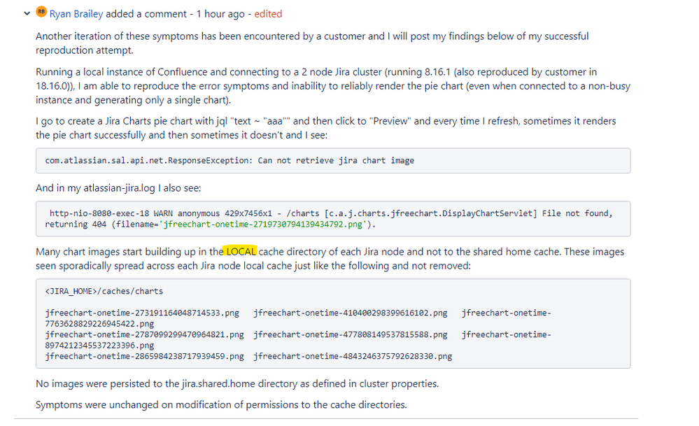

This issue was been matched with Atlassian bug https://jira.atlassian.com/browse/JRASERVER-67481
See updated comment with new behaviour
