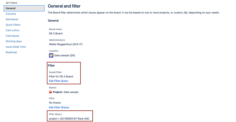

Hi @gohar.galstyan,
A board (either scrum or kanban) gets its data from a filter. You can find this filter in your board settings, on the general tab:
For your kanban board, edit the filter and update it to:
Project = <your project> AND component IN (APP, API) ORDER BY Rank ASC
And for the scrum board:
Project = <your project> AND component IN (Software, Hardware) ORDER BY Rank ASC
Hope this helps!
