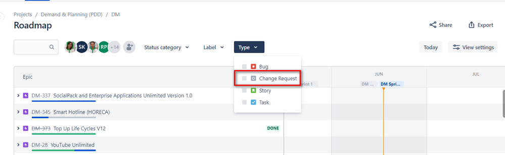

I created a new issue type with the name " Change Request" I can create an issue by selecting this issue type, but how can I add an icon to be nice. I can't find where can I add the icon with this new issue type.2021-06-17_185446.png

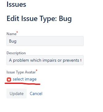

Assuming you are a general administrator…
  1. click on cog in upper right
  2. Select Issues
  3. click on Issue types
  4. find your issue type and click on edit
  5. click on “select image”
  6. save

I found it. thank you
Del Jensen
June 17, 2021
If you go to System-> Issues -> Issue Type then find the issue you want to change.  Select Edit on the right side.  Then you will see select image under the Issue Type Avatar.
