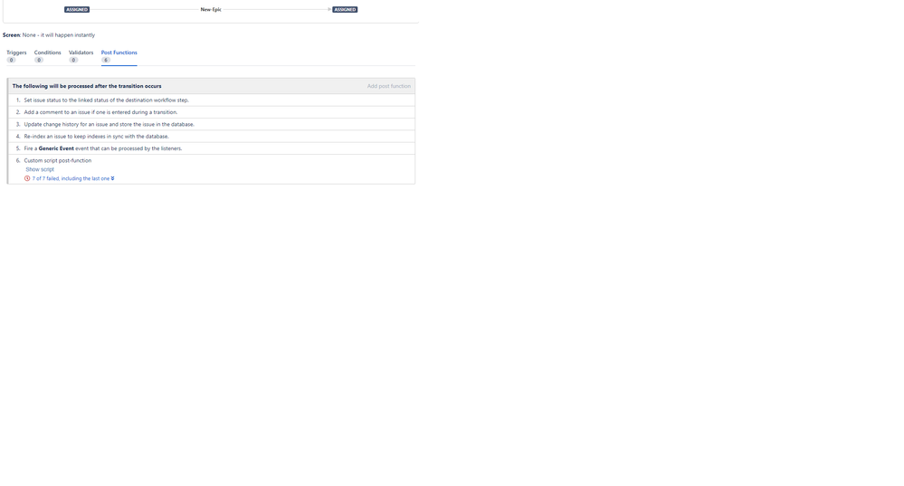

In one of our JIRA project, we have  a  workflow and on one of its transition I have written a custom script post function. Requirement is that on click of "New Epic" in issue view an epic will be created and will be linked to the parent issue.
This is the groovy code. It is working in our JIRA PROD which is 7.10.2. Recently we are working on upgrade and on JIRA DEV which is having 8.8.0 this code is not working.
createIssueObject() method is throwing exception.
So in order to troubleshoot it, I made the changes and tried to create just a Task instead of Epic but it is also failing.

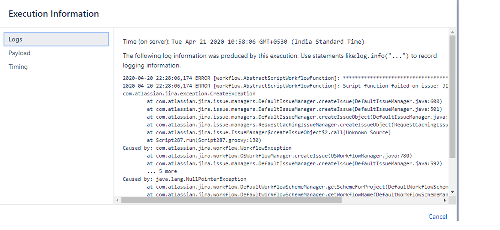

Exception :
Time (on server): Tue Apr 21 2020 10:58:06 GMT+0530 (India Standard Time)
The following log information was produced by this execution. Use statements like:log.info("...") to record logging information.
2020-04-20 22:28:06,174 ERROR [workflow.AbstractScriptWorkflowFunction]: *************************************************************************************
2020-04-20 22:28:06,174 ERROR [workflow.AbstractScriptWorkflowFunction]: Script function failed on issue: JIRAHELP-3818, actionId: 181, file: null
com.atlassian.jira.exception.CreateException
	at com.atlassian.jira.issue.managers.DefaultIssueManager.createIssue(DefaultIssueManager.java:600)
	at com.atlassian.jira.issue.managers.DefaultIssueManager.createIssue(DefaultIssueManager.java:501)
	at com.atlassian.jira.issue.managers.DefaultIssueManager.createIssueObject(DefaultIssueManager.java:611)
	at com.atlassian.jira.issue.managers.RequestCachingIssueManager.createIssueObject(RequestCachingIssueManager.java:201)
	at com.atlassian.jira.issue.IssueManager$createIssueObject$2.call(Unknown Source)
	at Script287.run(Script287.groovy:130)
Caused by: com.atlassian.jira.workflow.WorkflowException
	at com.atlassian.jira.workflow.OSWorkflowManager.createIssue(OSWorkflowManager.java:780)
	at com.atlassian.jira.issue.managers.DefaultIssueManager.createIssue(DefaultIssueManager.java:592)
	... 5 more
Caused by: java.lang.NullPointerException
	at com.atlassian.jira.workflow.DefaultWorkflowSchemeManager.getSchemeForProject(DefaultWorkflowSchemeManager.java:359)
	at com.atlassian.jira.workflow.DefaultWorkflowSchemeManager.getWorkflowName(DefaultWorkflowSchemeManager.java:330)
	at com.atlassian.jira.workflow.OSWorkflowManager.getWorkflowName(OSWorkflowManager.java:154)
	at com.atlassian.jira.workflow.OSWorkflowManager.getWorkflow(OSWorkflowManager.java:291)
	at com.atlassian.jira.workflow.OSWorkflowManager.createIssue(OSWorkflowManager.java:735)
	... 6 more

Shradha Singh April 22, 2020
Hi @Nir Haimov
Thanks a lot!  Really appreciate your response on this. I tried and it is working in JIRA 8.8.0.
So ideally usage of createIssueObject() was incorrect. In JIRA 8.x we should use
issueService.validateCreate() and issueService.create() methods for issue creation during transitions in workflow post functions. I had raised a case with Atlassian support also but I haven't received any solution/suggestion from them regarding these methods.
If you suggest I will open another thread but would you suggest our current PROD JIRA version is 7.10.2 and we are testing 8.8.0 in JIRA DEV where several workflow post functions are failing because of createIssueObject().
We have approx 500 projects and several workflows. So we will have to change  createIssueObject() everywhere i.e. in each and every transition post function groovy. What is the best way to compare APIs that might change between JIRA 7.10 & JIRA 8.x
Thanks for your quick response.
Regards
Shradha
Nir Haimov
April 23, 2020
Hi @Shradha Singh
Atlassian not supporting development in Jira, especially not in Scriptrunner which is a 3rd party plugin.
i would suggest you not to update to 8.8.0 just yet, many companies did not updated their plugins to compitable with Jira 8.8.0 (i guess because of the COVID-19)
I think 8.5.1 will be a better start, later you can upgrade to a later version of Jira, there are no API changes between Jira 8 versions.
Best way to solve you API code issues, is to see where the IDE shows you errors (in red lines) that means something change from your old code in Jira 7.X to new code in Jira 8.X
