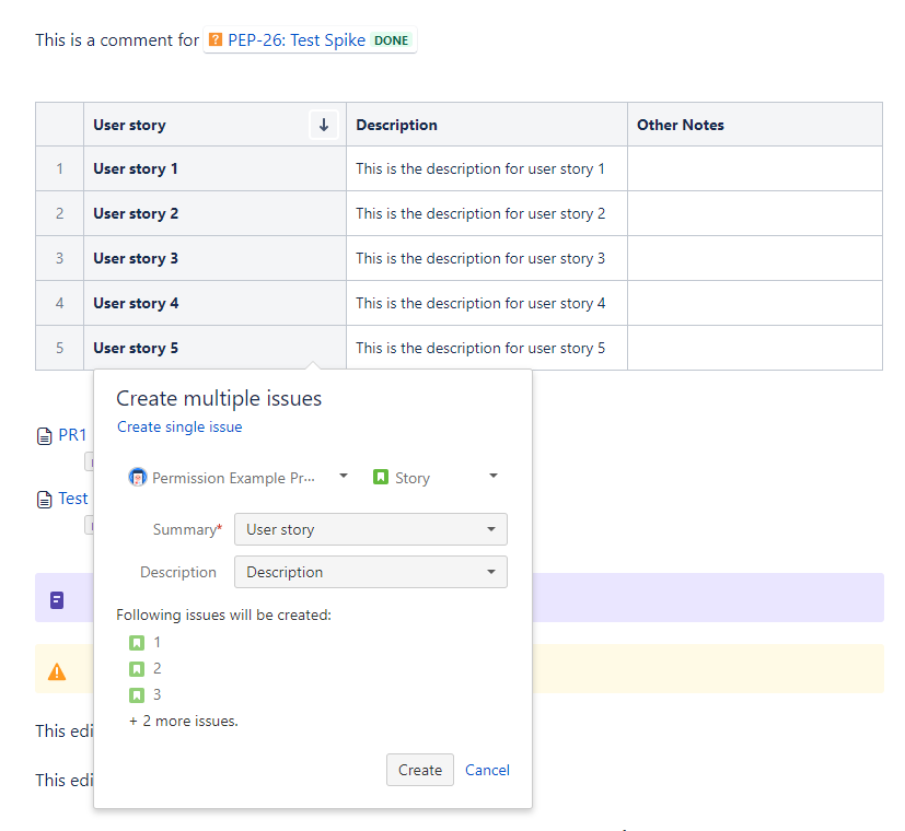

I’m trying to create multiple issues directly from the table in Confluence.

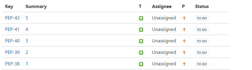

As you can see from the snapshot attached, the summary and the description are linked to the respective columns, but in the preview below, it says: the following issues will be created: 1,2,3, and so on…the question is: why it doesn’t show what it’s written in the description filed, meaning this is the description for user story…?

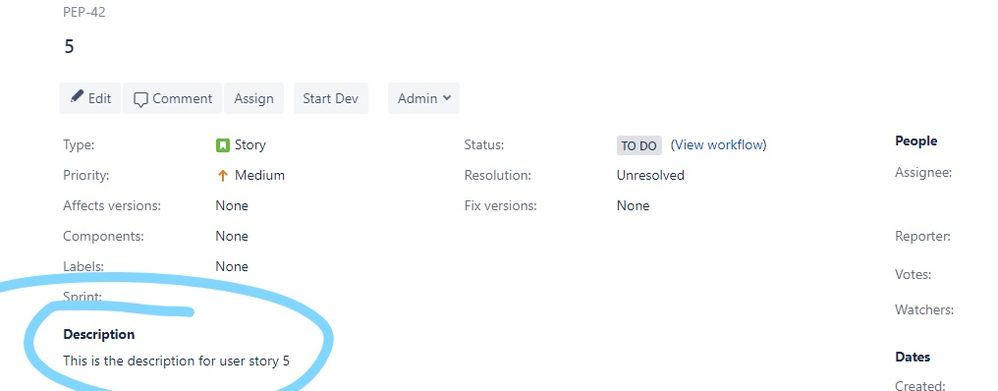

This is the result:
If then I open one of these issues just created, you can see the description field is populated, even if it’s not in the issue title where I would like to have it
Do you have any idea about why?

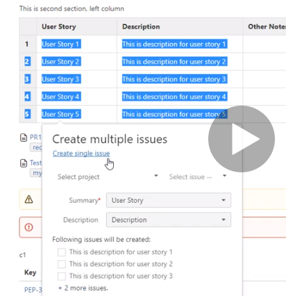

In the preview the description field I thought it should have said "this is the description for user story 1", "this is the description for user story 2" and so on, instead of saying 1,2,3,...

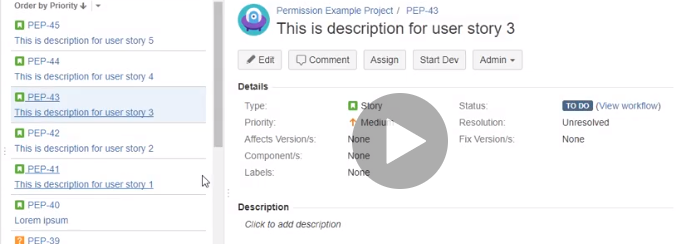

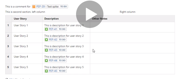

I attended a video course, and this is what happened to him:
You see how do they look different?
Even in the last snapshot, you see where I ended up with "this is the description for user story 5"? in the description field below...while, instead, the teacher, in the last attached snapshot, ended up with "this is description for user story 3" in the above section as the title...

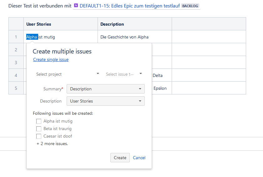

Hey Daniele,
found the (re)solution to your problem together with @Maximilian Semler where we expected it. The problem has several layers - we tested it in our Confluence- and Jira-environment. One thing is, that it's enough to mark only one word and then choose the respective sources.
But, nevertheless, then we had another problem - the description field read "1", "2", "3", and so on. So we excluded the numeration of the rows. That worked pretty well.
