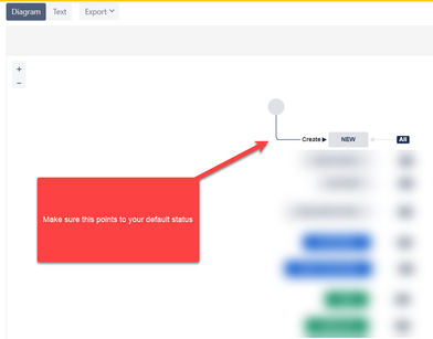

1. Make sure your default status is specified in your workflow (see below). You need to do this for both of your workflows.

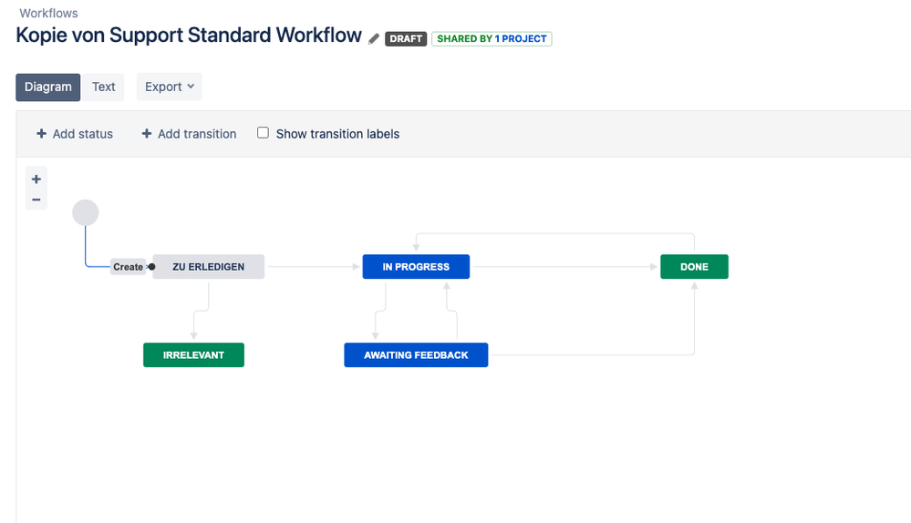

The status is the default one for both workflows and I've also checked properties, validators and post functions to resemble the other workflows in our instance where the expected behaviour actually works.

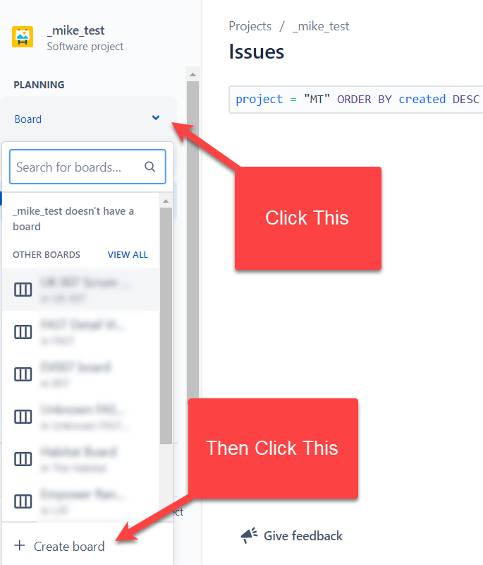

Now create your board by following these steps:
I think you now how to setup the columns and statuses in your new kanban board. If not, let me know.
