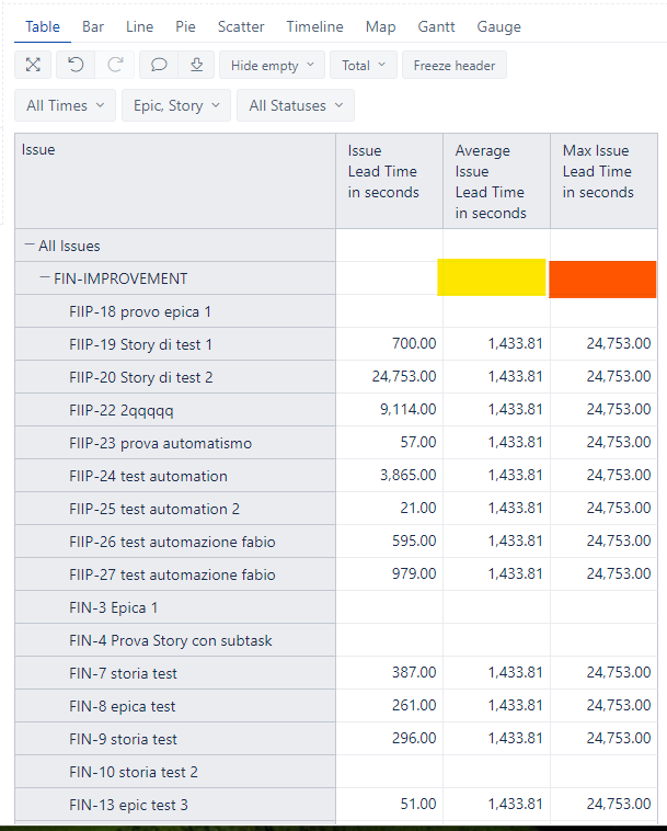

I created a report that shows, for every issue in a project, my (custom) field Lead Time in seconds using the Measure:
[Issue].CurrentHierarchyMember.get('Lead Time in seconds')
, but I want to show the average and the max value too, for those values.
Using the 'Add calculated' > 'Statistical' > 'Average' / 'Max' tools, I obtained the values but listed in every rows:
I would like to insert the Average value in the yellow slot and the Max value in the orange one. It is possible?
Or if not, there is a way to report this value only one time for a project?
Thank you!
You should be able to create a calculated measure that performs the math (avg, max, etc.) only at the Project level in the hierarchy.

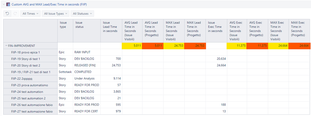

I created a report with 2 similar measures for Average and Max:
- AVG/MAX Lead/Exec Time in Seconds (Issue Visible) -> using Descendants function (yellow)
- AVG/MAX Lead/Exec Time in Seconds (Project) -> using VisibleRowsSet() function (orange)
From the screen, you see that when the project cell "FIN-IMPROVEMENT" is exploded, the measures are the same:

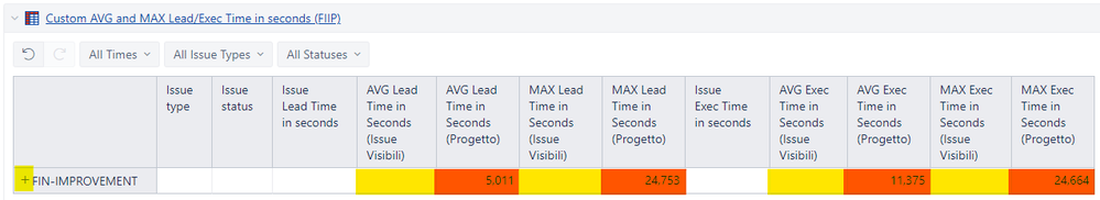

But when I implode the project cell, you see that the yellow cells are blank, while the orange ones remain correctly valued:
I want to know if there is a function in eazyBI for checking if the [Issue].CurrentHierarchyMember (in this case, the project cell FIN-IMPROVEMENT) is imploded or exploded, for creating an unique column for both the codes.
Thank you again, bye!
It looks like the issue you're having here is in the nature of the two measures you created.
One uses Descendants() and one uses VisibleRowsSet().
VisibleRowsSet will only work for rows that are visible on rows. So, when you collapse your rows there are no rows visible and, thus, the result is an empty cell.
VisibleRowsSet() works well if you want to show all of the rows in your report/chart, along with the summary values.
Descendants() (or something like Descendants()) is better if you intend on only displaying the roll-up/summary results and hiding the rows.
My point in my original comment was that Descendants will include ALL members under the specified hierarchy member. Since you're using Issues for your Rows you may have thousands and thousands of them which can hurt performance. You may want to include a Filter() to limit this set depending on the nature of the report. For instance, I have reports that return the latest 6 sprints from a board - as opposed to ALL sprints, which is what Descendants would do if not filtered. Here's the eazyBI documentation for Descendants(). A couple of examples are given which should help explain it more clearly. https://docs.eazybi.com/eazybi/analyze-and-visualize/calculated-measures-and-members/mdx-function-reference/descendants
There are other ways to limit the number of rows in the report. This is just an option.
Hope that helps!
-jj

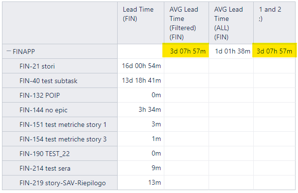

a few days have passed but I have not forgotten your answer ^^
I found a solution that could be useful to other people as well, but it might not necessarily be the most efficient.
CASE WHEN [Issue].CurrentHierarchyMember.Level.Name = 'Project' THEN
IIF(
IsEmpty(
AVG(
VisibleRowsSet(),
[Measures].[Lead Time (FIN)]
AVG(
Descendants([Issue].CurrentHierarchyMember, [Issue].[Issue]),
AVG(
VisibleRowsSet(),
END

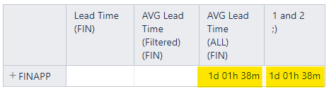

Practically, this measure works both when the row is left closed and when it is exploded (the bold part does the check).
The solution appears like this when imploded:
, and like this when exploded:
In case anyone has a way to improve or speed up this report, I hope they show up!
Bye !
