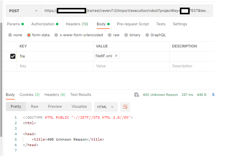

I am trying to call API for robotframework in order to import Xray.
But when I call and send my request, I am getting error as "Your browser sent a request that this server could not understand."
I tried to call API both with Postman and curl (in addition Postman sometimes give 500 Internal server error)
POST Method and using form-data ( upload output.xml) (You can see screenshot)
URL : https://xxxxxx/jira/rest/raven/1.0/import/execution/robot?projectKey=TEST&testExecKey=TEST-394
and The curl;
curl -D- -u user:psw -X POST "https://xxxxx/jira/rest/raven/1.0/import/execution/robot?projectKey=TEST&testExecKey=TEST-208" -H "Content-Type:multipart/form-data" -F "file=@output.xml"
Do you have an idea? Did I do some wrong thing?
I solved the issue. The problem is related the test which I have already created on Xray. Since it is a test created before, when I call the endpoint with the same output.xml again, it does not create it. You can close ticket. Thank you for your support
The URL is wrong, it does not "jira" on it.
Wrong URL: https://xxxxx/jira/rest/raven/1.0/import/execution/robot
Right URL: https://xxxxx/rest/raven/1.0/import/execution/robot

Thank you for your reply, but also I tried this url on POSTMAN. In that case, I am getting another error.
The problem could be related to the Test already created on Xray.
However, it will depend on the permission and configuration that you have, so in these specific cases, it is best to contact the Xray Support (http://xraysupport.getxray.app).
