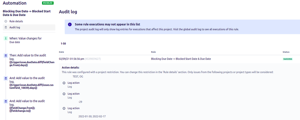

Testing this out {{fieldChange.from}} and {{fieldChange.to}} return correct date variables.
However when I try and compute the difference using {{fieldChange.to.diff(fieldChange.from).days}} I get NULL in return.
I did confirm the diff syntax is correct by using two other date fields. This returned the difference in days successfully (in this case customfield_10039 == start date) {{triggerissue.dueDate.diff(issue.customfield_10039).days}}
Do {{fieldChange.to}} and {{fieldChange.from}} not work inside the .diff().days function?

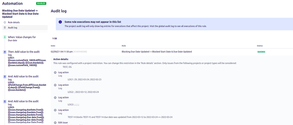

I realised I missed your first suggestion @Bill Sheboy and that did the trick. The following smart value is now working, it calculates the change in duedate of a parent issue and adds the same difference to the due date of a child issue.
{{issue.dueDate.plusdays(fieldChange.from.toDate.diff(triggerissue.duedate).days)}}
When used in the structure found in the screenshot below I can now use changes in the due date of a blocking issue to update both the start and due date of any blocked issue.
My log rules break down how this works a little more and use .longDate to make things more readable:
LOG1-DUE DATE TRIGGER: {{triggerissue.key}} blocks {{issue.key}} and {{triggerissue.key}} due date was updated by {{fieldChange.from.toDate.diff(triggerissue.duedate).days}} days, updated from {{fieldChange.from.toDate.longDate}} to {{triggerissue.duedate.longDate}}
LOG2-DUE DATE CHANGE: Blocked issue {{issue.key}} due date added {{fieldChange.from.toDate.diff(triggerissue.duedate).days}} days, updated from {{issue.dueDate.longDate}} to {{issue.dueDate.plusdays(fieldChange.from.toDate.diff(triggerissue.duedate).days).longdate}}
