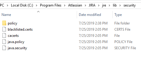

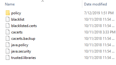

I don't quite understand, what file are you referencing? cacerts file is there on both screenshots. If you are refering to the intermediate.cer, this is the one I used to sign the locally issued certificate.
@O ZCan I use any of the files from my backup for my upgraded version? I made a backup of the entire directory and see a cacerts file a keystorePKCS12 file etc. I wasn't the person who did all this the first time around. As that person left our company. And this is the very first time we are upgrading any Atlassian product.
@S_ Toyo  Yeah you can try with the cacerts file from a backup. Otherwise go to any website you host with your self-signed cert with firefox, go to the lock symbol -> secure connection -> more information -> security -> show certificate -> details -> certificate hierarchy *click* -> Export.
This should be your file for the "-file" parameter.
