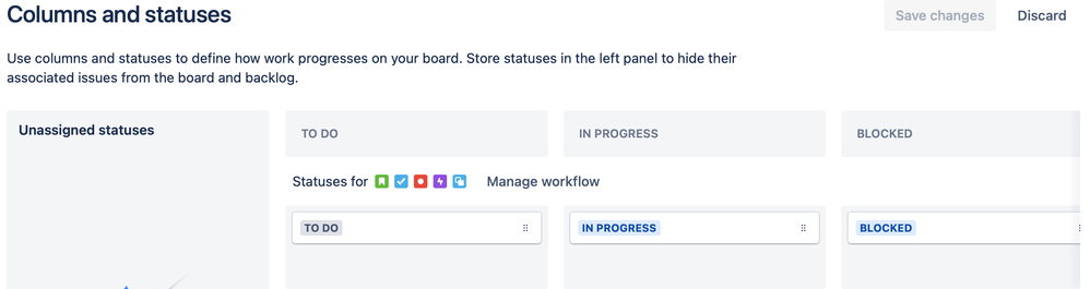

Those are not statuses on the sprint board, they are GROUPS of statuses (go into the board settings to see what statuses are actually there in the columns tab).
You can then use various gadgets and reports to show you the workload in a sprint. I don't know which version of server or what add-ons you have, so I can't be more specific.

After going into the board settings, it seems like there is a status for each column. (when scrolling to the right, it shows each columns with review, validate, and done after blocked in screen shot below)
I believe it is the cloud server and do not have any add-ons. I was exploring any built in functions first where it does not cost anything. Are there any recommended free add-ons? Basically, I would like recreate the table, except instead of counting the number of issues/stories, I would like to display the number of story points.

Ah I see, these are Team managed projects - that's an important consideration. The reports you can use are limited - you'll have to explore the ones found in the reports tab in the project settings. As far as I know, that's pretty much all you can do.
