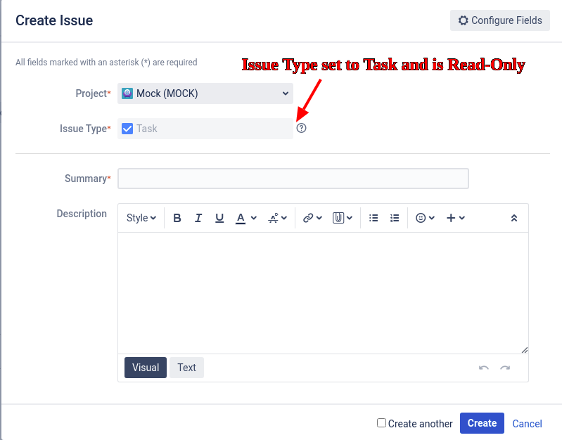

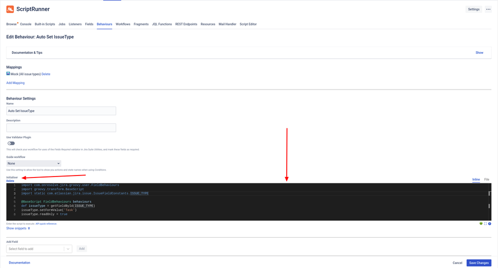

Since you want this to load the moment the Create screen is displayed, it would be best to use the Behaviour Initialiser instead of the Server-Side Behaviour.
Below is a screenshot of the Behaviour configuration:-
Below is a test screenshot for your reference:-
If you observe, when the create screen is loaded, the Issue Type is by default set to Task and is also set to Read-Only.
