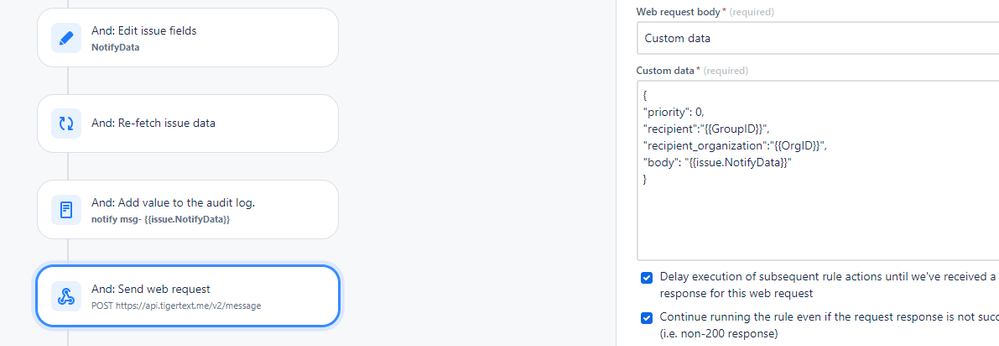

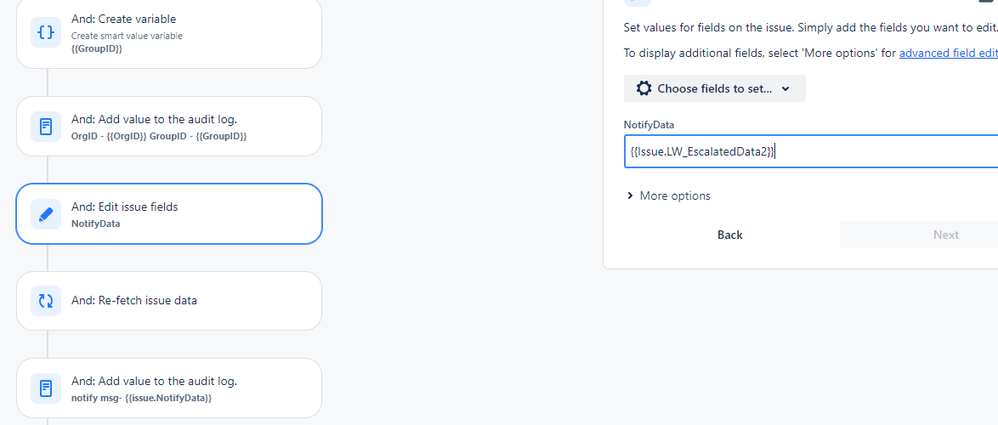

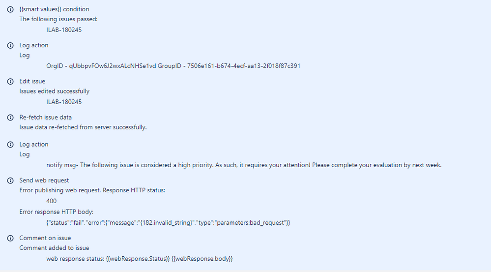

I have a string in a multiline field (as seen above) and I want to send it via webservice.
I found out that I could not send multiline in webservice so I created a new simple text field with the same text and I sent it via the webservice but I got an invalid string error all the time.
When I set explicitly the message with the new line chars in the Jason body, it can send it through.
The automation:Trigger.PNG
The audit log:auditlog.PNG

Rather than moving the data to another custom field, have you tried using one of the encoding functions on the original multi-line field and then sending that in the message?  That should preserve the characters using the relevant protocol.
https://support.atlassian.com/cloud-automation/docs/jira-smart-values-text-fields/#Encoding
david_levy
March 12, 2024
Thanks, Bill,
I tried the {{issue.summary.jsonEncode}} and it works as you suggested.
