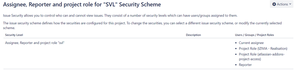

Yes, is what I do. I put the group in Browse Projects (I don't know if is the good thing because it's write project and issues "Ability to browse projects and the issues within them.") and I create a security :
with the current assigned, the reporter and another group, they can see all.

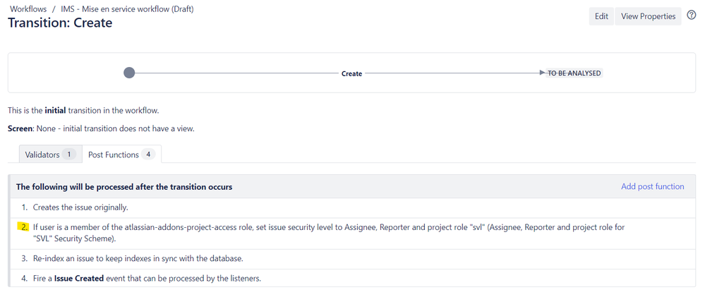

I call this security in my workflow on the transition Create.
But my group see all issues,

Additionally, as I said, do not use the atlassian-addons-project-access role. Users should not be assigned to that role. Create a different project role for this group of users.

On the workflow at the transition create :
For all the issues in that project that you don't want the users to see you also need to assign a Security Level to those issues and it needs to be a Security Level that does not include those users.
Security Levels are used to limit the visibility of an issue. If no Security Level is assigned to an issue, then it is visible to everybody that has the Browse Projects permission.

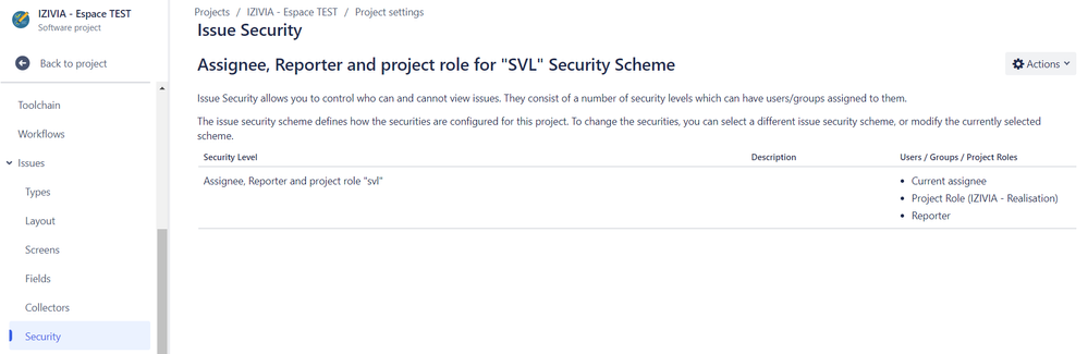

In my capture, is the security for my issues and I put the Security Level only for reporter, current assigne and the project role who must see everything.
And after I assigned this Security Level in my workflow on the project role to whom I want who only sees theirs.

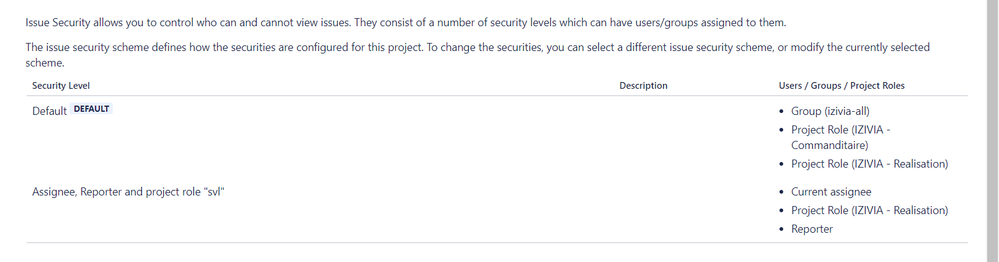

Finally, by adding a security level by default because I thought that maybe, I had misunderstood your last point, it works a little better.
I just have the problem that my SVL group doesn’t see anything even if it's create the issue, and it's reporter on the issue

1. You created the Issue Security Scheme with the one Security Level and you associated that Issue Security Scheme to your project.

1. Now, I have 2 security level. one for Joe and Sally and one for Bob this is the default (I put all the people we can see).
2 and 3. For me, it's in the workflow with my issues I say in the create transition, the level security for "IZIVIA - SVL" is Reporter, IZIVIA-Realisation and Current assignee

1. Can you please provide a current screen image of the Security Level configurations?
2. Can you show use the workflow details where you are setting the Security Level?
