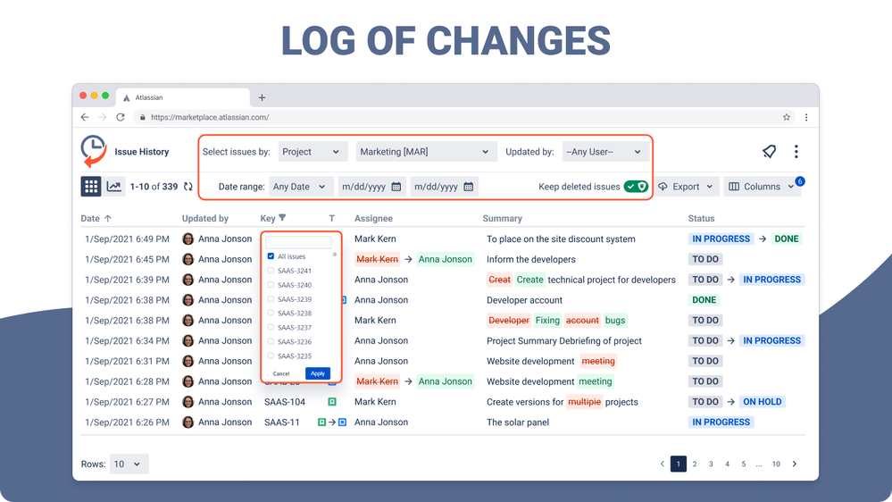

Hi @TP
If you're comfortable with using solutions from the Marketplace, there is one I'd like to suggest from my team. Consider Issue History add-on. It shows all the updates made to the selected issue list. So you will see issues, their assignees, sprints and any other column. You can filter by project, sprint, assignee, label, etc.
Let me know if it helps.
