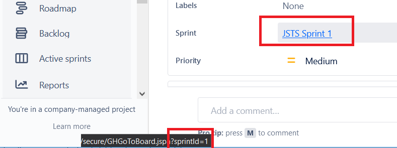

I think you need to filter by sprint ID and sub-task issue type.. Something like this
sprint = <sprintID> and type = Sub-task
This should give you all sub-task in a given sprint. You can find ID of a spring by hovering your mouse over Sprint name in the parent ticket for example..
