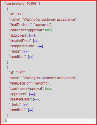

If you look at the REST API result for Get of the test issue, you get this (I've collapsed unnecessary sub fields):
Any suggestions from anyone on how I can get access to the specific ID?
Well, solved my own problem by digging into https://confluence.atlassian.com/automation/jira-smart-values-lists-993924868.html
using
{{issue.customfield_10106.last.id}}
gave the answer of 476.
