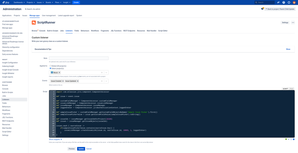

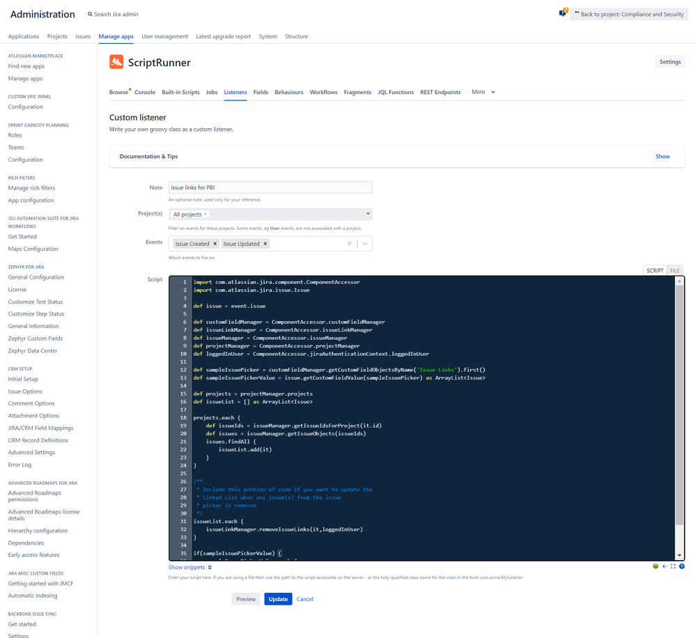

Below is a print screen of the Listener configuration:-

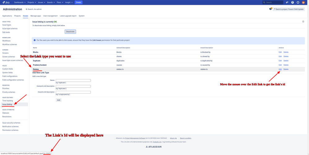

To determine what type of Link you want to use, you will need to visit the Issue Linking page as shown below:-
Once you have decided which link type you wish to use, you will need to move your mouse over the Edit link.
You will then see the Issue Link's ID. this is the ID you will need to use in this line of code:-
issueLinkManager.createIssueLink(issue.id, sourceIssue.id, 10003, 1, loggedInUser)

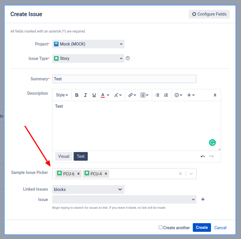

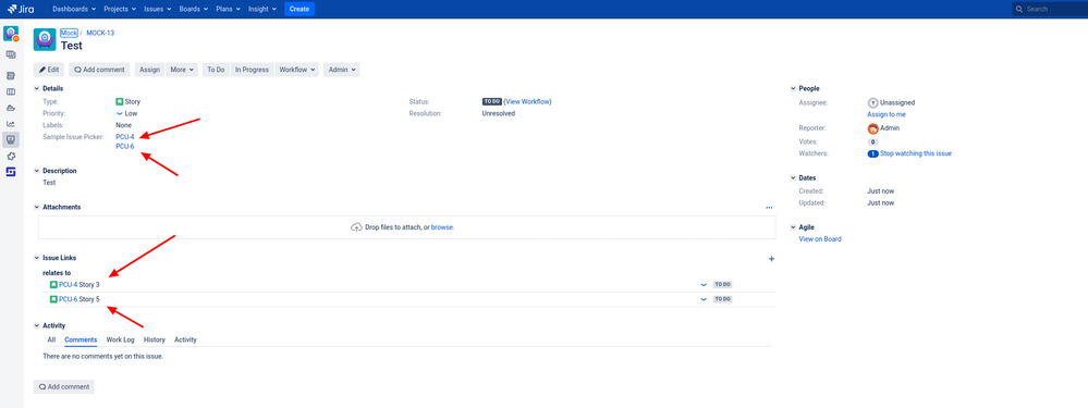

Below are few test print screens:-
1) When the issue is being created, two linked issues are added as shown below:-

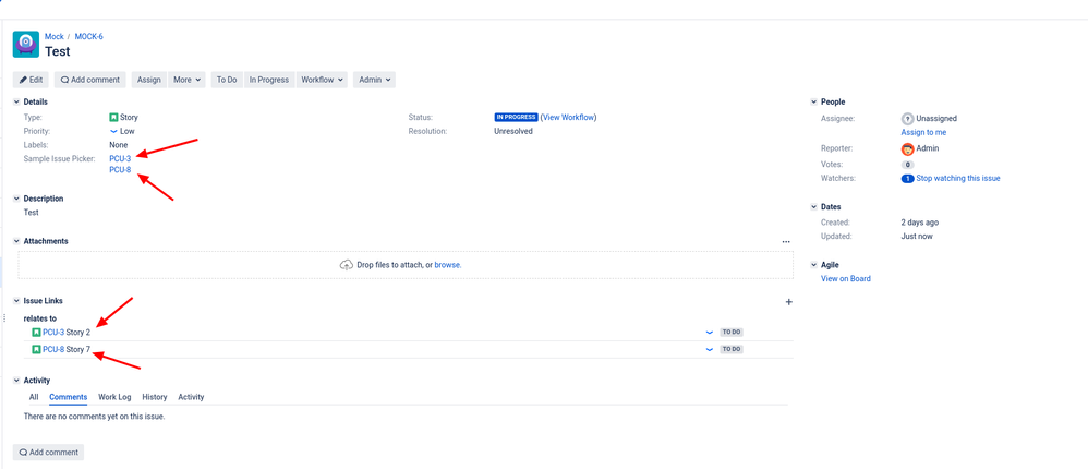

2) Once the issue is created, the Issue Link is automatically created as shown below:-

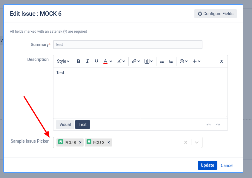

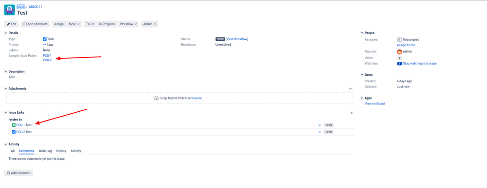

3) Similarly, if an issue has already been created, and the links are included as shown below:-
test3.png  The issue link will also be created as shown below:-

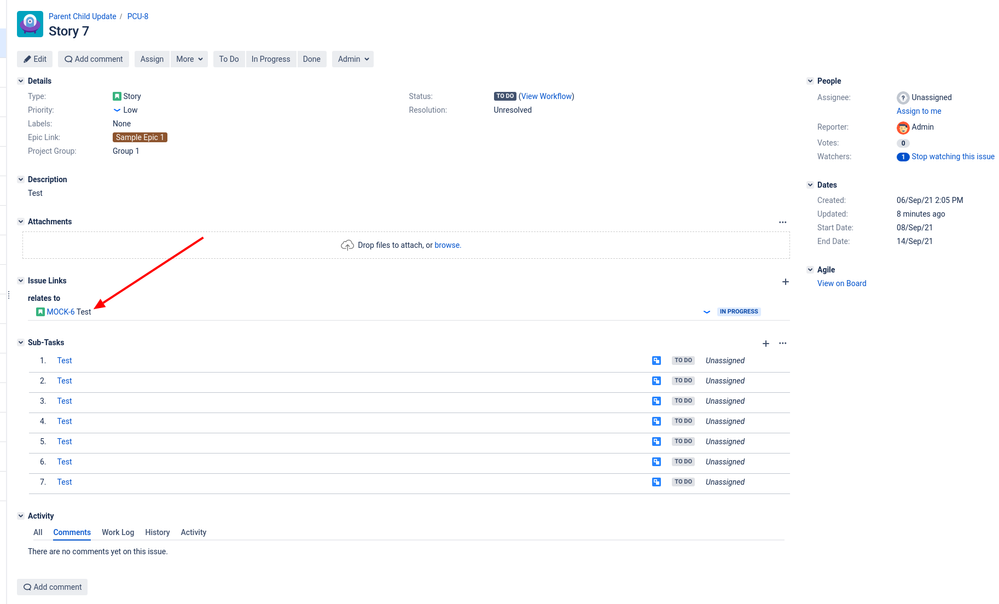

RSP
September 15, 2021
Hi Ram,
Thank you so much for your response.

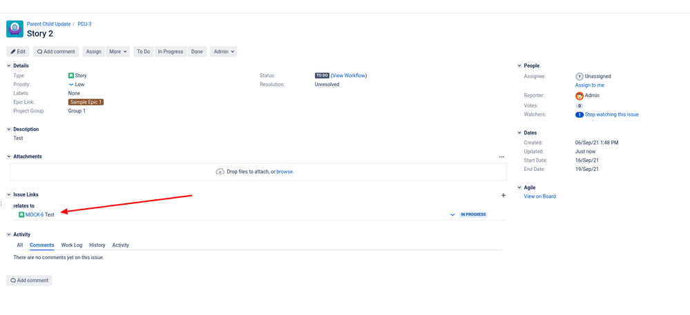

But the thing is I want linking should be done from both the sides like as MOCK-6 is showing PCU-8 and PCU-3 in Issue Links same should be done from PSU-6 side need to show MOCK-6 in Issue Links
Ram Kumar Aravindakshan _Adaptavist_
September 15, 2021

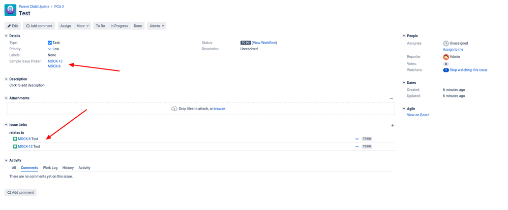

Hi @RSP ,
When a link is created from one issue to another, the issues involved in the link will automatically have the link.
When the link was created in MOCK-6 to PCU-3 and PCU-8, the link was created in MOCK-6 as well as in PCU-3 and PCU-8.
There is no need to do an additional linking config.
Below are the print screens for your reference:-

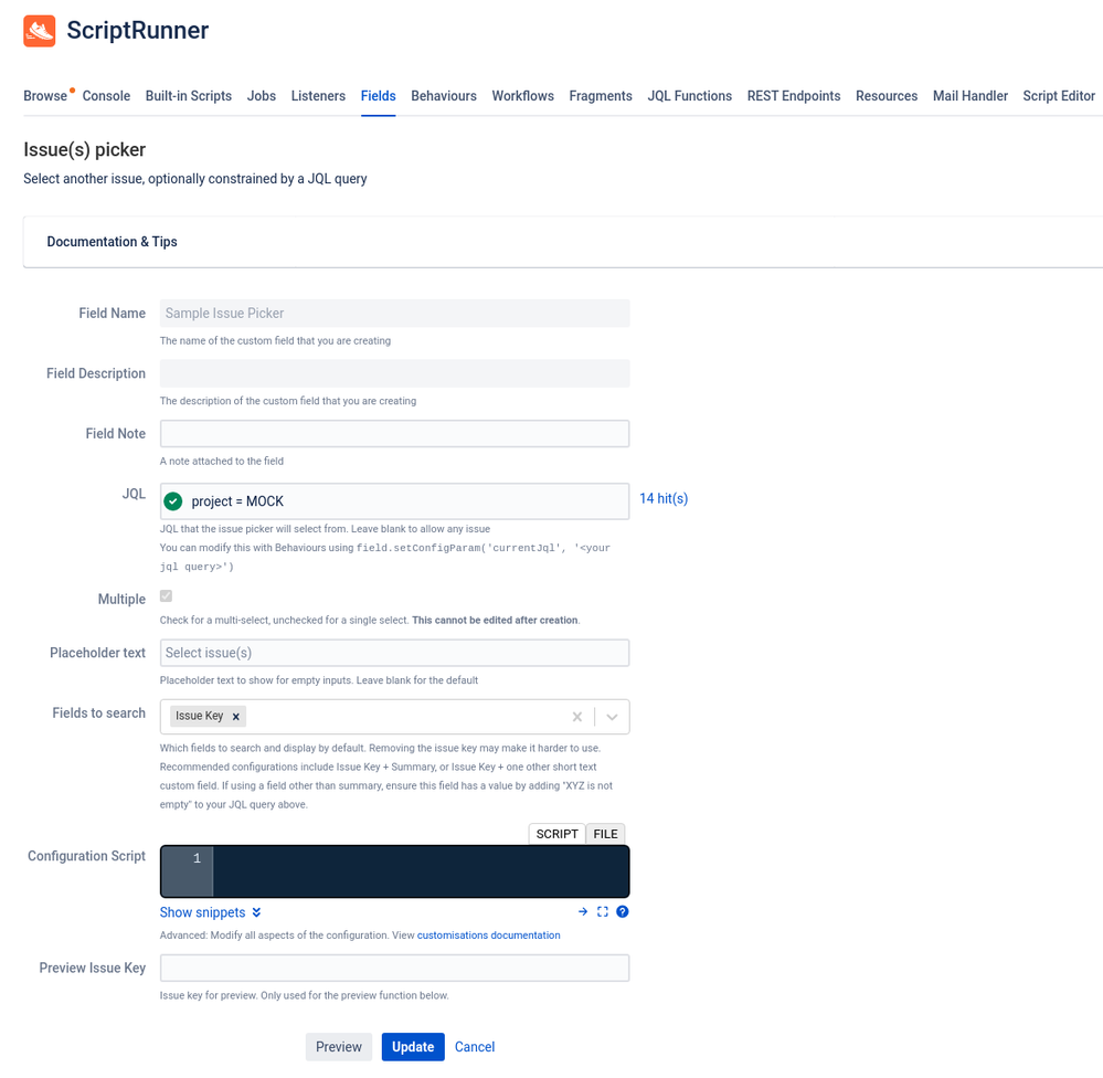

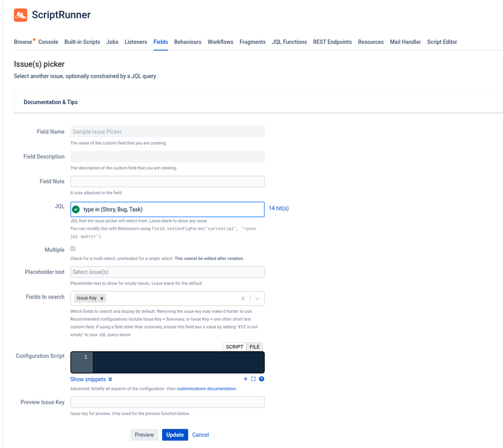

First, change the JQL Query in the Issue Picker to something that is not Project-specific  (i.e. if you want it to contain issues from all projects) for example:-
type in (Story,Bug,Task)
also, as shown in the print screen below:-
Next, you need to update the Listener code to this:-
import com.atlassian.jira.issue.Issue
def issue = event.issue
def customFieldManager = ComponentAccessor.customFieldManager
def issueLinkManager = ComponentAccessor.issueLinkManager
def issueManager = ComponentAccessor.issueManager
def projectManager = ComponentAccessor.projectManager
def loggedInUser = ComponentAccessor.jiraAuthenticationContext.loggedInUser
def sampleIssuePicker = customFieldManager.getCustomFieldObjectsByName('Sample Issue Picker').first()
def sampleIssuePickerValue = issue.getCustomFieldValue(sampleIssuePicker) as ArrayList<Issue>
def projects = projectManager.projects
def issueList = [] as ArrayList<Issue>
projects.each {
def issueIds = issueManager.getIssueIdsForProject(it.id)
def issues = issueManager.getIssueObjects(issueIds)
issues.findAll {
issueList.add(it)
* Include this portion of code if you want to update the
* Linked List when any issue(s) from the issue
* picker is removed
issueList.each {
issueLinkManager.removeIssueLinks(it,loggedInUser)
if(sampleIssuePickerValue) {
sampleIssuePickerValue.each {
issueLinkManager.createIssueLink(issue.id, it.id, 10003, 1, loggedInUser)
I hope this helps to answer your question. :)

By setting the Listener to Global (All Projects), it can work on all my projects.
As mentioned in my previous comment, did you ensure that you have updated the Issue Picker's JQL Query and remove the option of which project you want it to work on, and instead specify what issue types you want it to work on, i.e. for example from:-
project = MOCK
to
type in (Bug, Story, Task)
Below is a print screen of some test cases on different projects:-

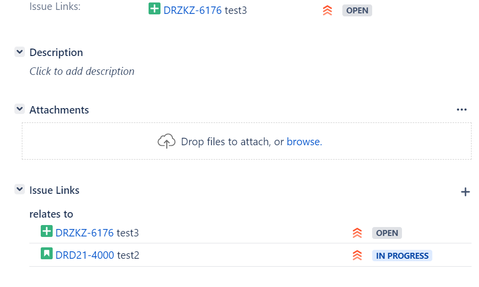

RSP

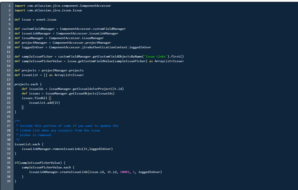

September 21, 2021
Hi Ram,
I have added the same listener code just changed the field name as "Issue Links".
Still issue not get linked. Before it was working for single project.
Please find the attachments.
Please check and let me know.
Thank You
September 22, 2021 edited
Hi @RSP,
If this is the case, you can remove this portion of the code:-
issueList.each {
Thank you and Kind Regards,
Ram
RSP
September 23, 2021
Hi Ram,
Script is working completely fine now. Thanks a lot.

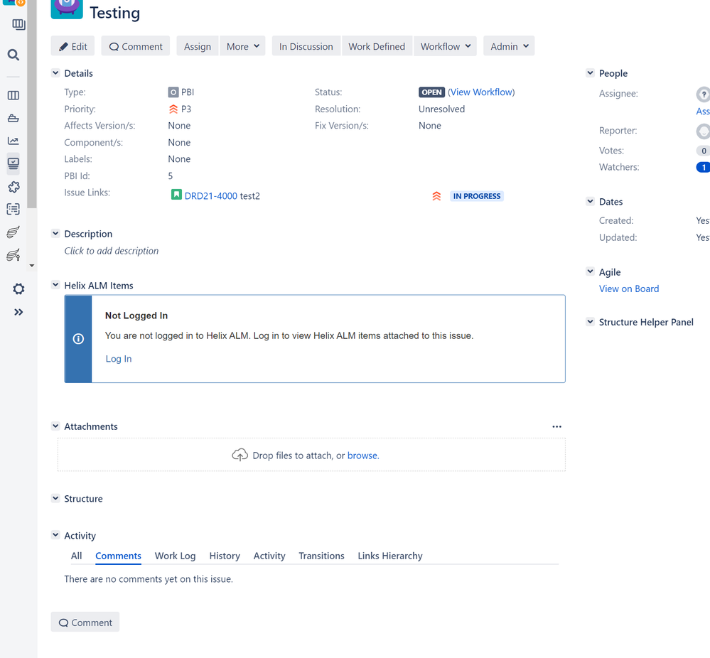

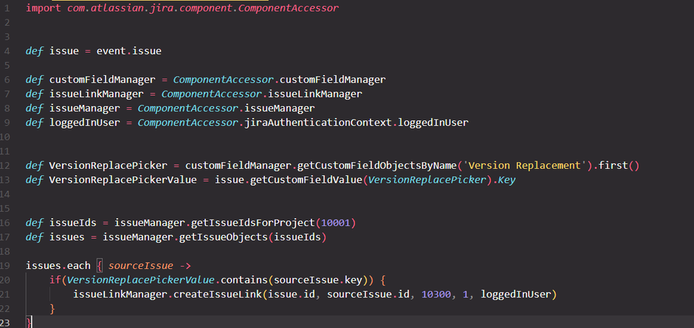

Aaron Coonce January 4, 2023
@Ram Kumar Aravindakshan _Adaptavist_
I am doing these steps for a single project. It is working great! However, when I select my sample picker value of Media-80 it links both 80 and 8! Any ideas?
def VersionReplacment = customFieldManager.getCustomFieldObjectsByName('Version Replacement').first()
def VersionReplacementPickerValue = issue.getCustomFieldValue(VersionReplacment).toString()
def issueIds = issueManager.getIssueIdsForProject(10001)
issues.each { sourceIssue ->
    if(VersionReplacementPickerValue.contains(sourceIssue.key)) {
        issueLinkManager.createIssueLink(issue.id, sourceIssue.id, 10300, 1, loggedInUser)
January 8, 2023
Hi @Aaron Coonce
Could you please share a screenshot of the issue link?
Also, could you please confirm the version of ScriptRunner and Jira that you are testing with? I am asking this because, in your comment, you mentioned:-
What you have mentioned seems to be an old bug which was fixed and released. Hence, I need to confirm if you are using an earlier version which doesn't contain the fix.
I am looking forward to your feedback.

Aaron Coonce January 12, 2023
Ram,
I appreciate your assistance I actually got it to work! I took your formula and adjusted it a little! Thanks for solid explanations!
