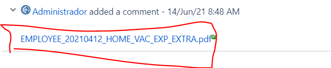

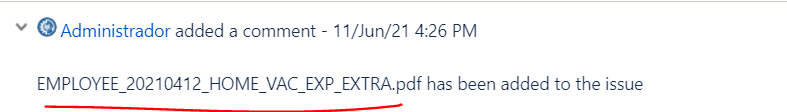

hello,
i want to attach pdf attachment(link) in comment using
def commentManager = ComponentAccessor.getCommentManager()
def textComment = fnm + " has been added to the issue"
commentManager.create(issue, currentUser, textComment, null, null, new Date(), true)
above code create comment as "text" not " pdf link",like below

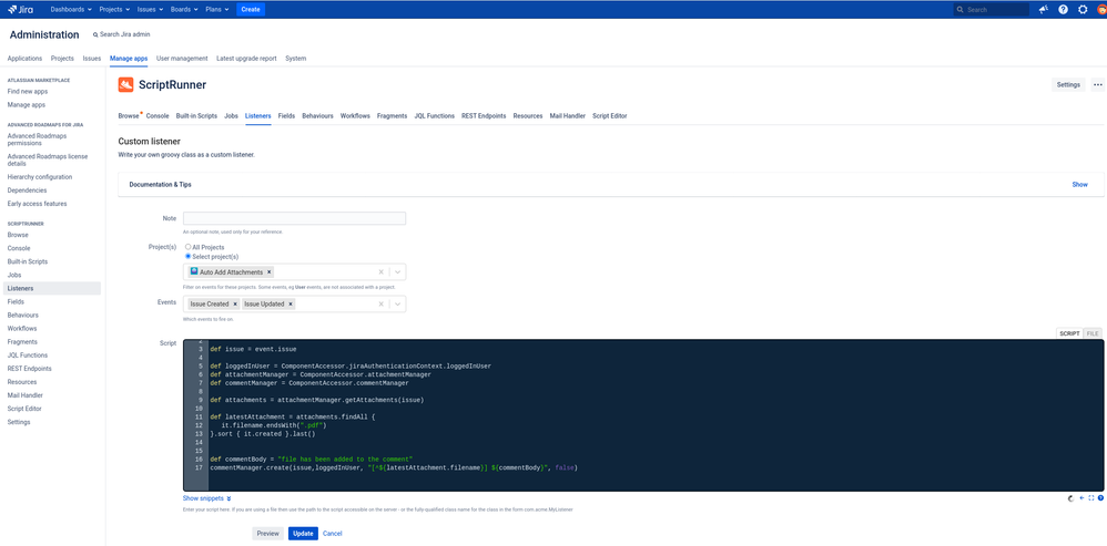

Below is a print screen of the listener configuration:-

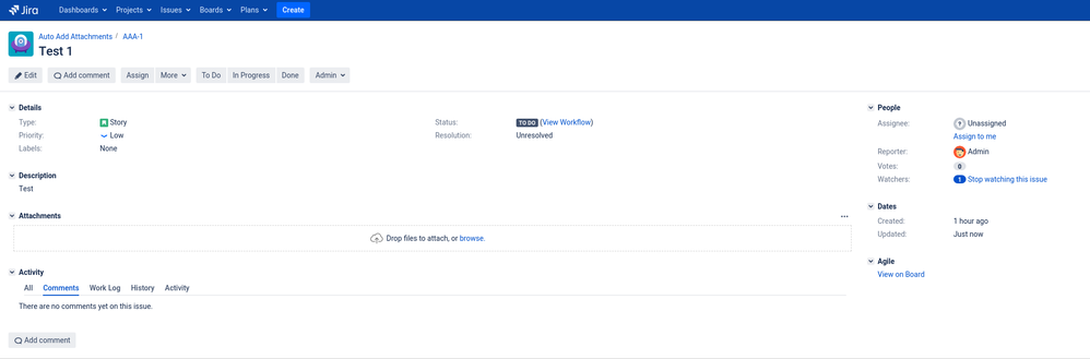

1) First, when the issue is created, no attachments are added, as shown below.

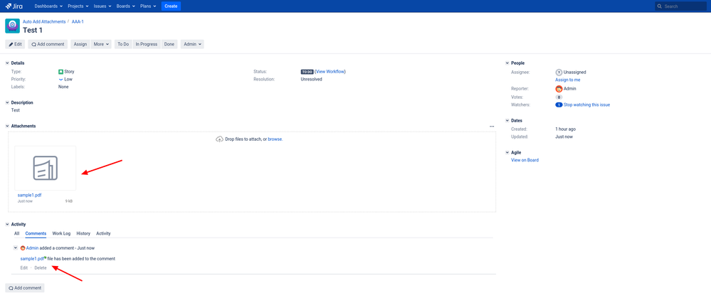

2) Once an attachment is added, refresh the page, and you will see the comment is automatically added, as shown below.

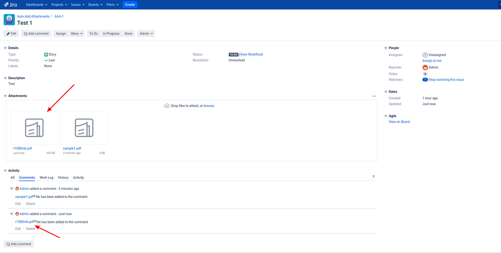

3) Adding other pdf attachments, and the comment is updated as well as shown below:-

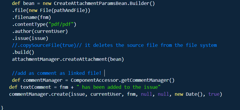

@Sneha Gole i found this discussion
and saw your code .
I am able to attach the file but not to comment but to the issue . Could you help how can we prevent it
Aakanksha
