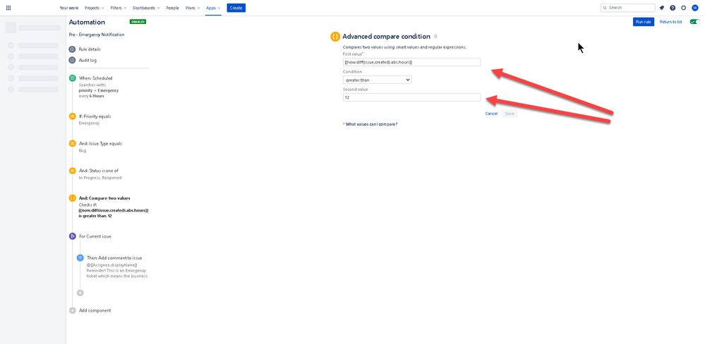

Hi ,
I am trying to automate the message sent to everyone if the time that the ticket is created compare to now is greater than 12 hours
but it seems like it i am missing something. can you please let me know what am I missing?
What are you seeing? Are there any errors in the audit log?
Have you tried to remove the abs expression and only use hours? Created should always be in the past when this rule fires, so the absolute value should not be necessary.
{{now.diff(issue.created).hours}}
Best regards,
Bill
Hi @Bill Sheboy ,
After struggling with it i found there was a problem with jira so i had to first check the status and then the priority and then the type otherwise for some reason the tickets will not filter correctly. after that I checked the state that returns true or false. this way it worked perfectly and everything was fine.
{{now.isAfter(issue.created.plusDays(0.5))}}
Equals
true
