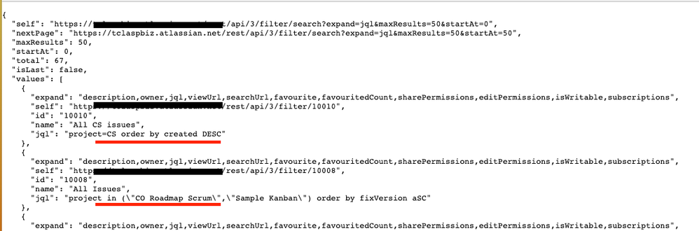

If you want to follow Bill's suggestion you need to use this URL in a browser tab:
https://<your jira URL>/rest/api/3/filter/search?expand=jql
Note that you need to replace <your jira URL> with the actual base URL for your Jira instance.
You will get output similar to the following - a list of the filters on your instance including the JQL for each filter. Notice the JQL underlined in red:
You will have to search that output for the text of your project key or project name contained in the JQL statements.
Note that if you have a lot of filters the API will paginate the data. That means the first execution will return only the first "page" of results. Notice the sixth line in the output that says "total": 67 and the third line that says "maxResults": 50. That tells you that there are a total of 67 filters on the system and only the first 50 have been returned.
