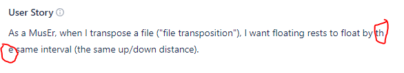

I'm working in JIRA.  I'm writing paragraphs.  For words at the end far right of the line, JIRA arbitrarily breaks the word into nonsense "syllables" that are very confusing to look at.   For example, it might break "the" into "th" plus "e."   Other than switching to "old view" (which does not arbitrarily break words), how to fix?  Is there a setting somewhere?

Yes, it looks like I am arbitrarily hitting return in the middle of the word.  But I am not doing that.  JIRA is breaking up the word.

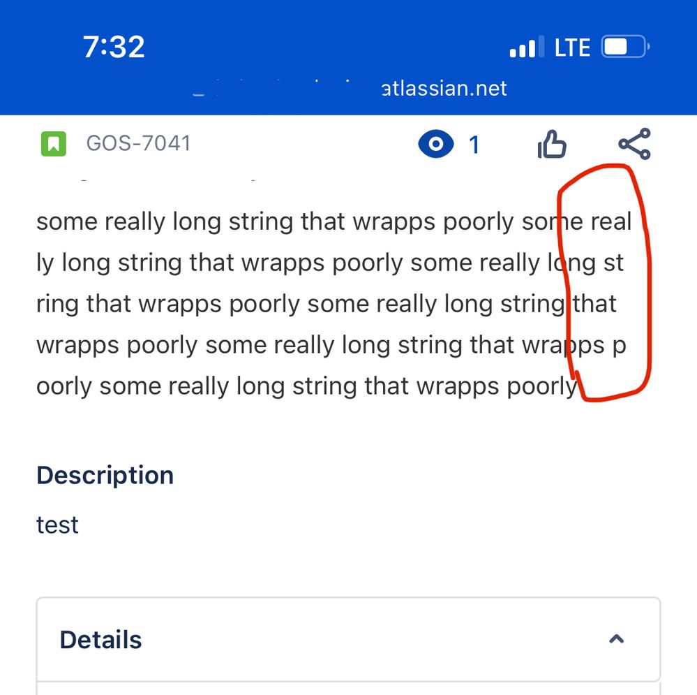

Here are some screenshots of what we see
Desktop
Mobile
