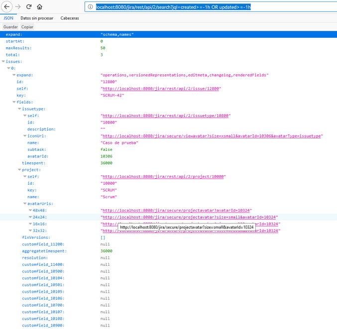

Of course, this is an example of my local JIRA instance do this call:
http://localhost:8080/jira/rest/api/2/search?jql=created%3E=-1h%20OR%20updated%3E=-1h
I use Firefox to view the result that has a plugin to view JSON formatted:
Best regards,
Adrián.

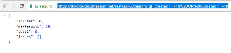

In your cloud instance, I did the call without authenticating and this is the result:
https://itc-cloudio.atlassian.net/rest/api/2/search?jql=created%3E=-1h%20OR%20updated%3E=-1h
In the navigator side works fine, then the problem is the java side, you scape the string correctly?
