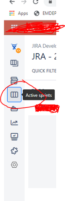

Hi @sgole,
I tested this on browser Console and it worked:
$("[data-link-id=\"com.pyxis.greenhopper.jira:project-sidebar-work-scrum\"]").remove()I hope that this helps.
Moga
And yea, it's jQuery. Let me know if you need that to be Javascript.
hii @mogavenasan ,
i have used above code in web resources(.js) but its not working . can you please suggest something else
How about you place that inside the Jira Announcement banner? Make sure you have added some logic before removing the element, for example, check the URL and check if the element exists and etc.
Hi @sgole,
I don't understand what you mean by "web resources".
When you mentioned that it's not working, have you tried to do some logging? Does the Javascript able to find the element on the page? Is there any error on the Console log?
hii @mogavenasan ,
i have create fragment- web resources like below .
and in HideCf.css i have written ,
$("[data-link-id=\"com.pyxis.greenhopper.jira:project-sidebar-work-scrum\"]").remove()but it wont work .
Hi @sgole,
I don't think jQuery commands should be placed in a stylesheet file (.css). And this Install web resource - is this from Scriptrunner?
Are you sure you are using this function correctly? You might want to refer to this doc for a better understanding. For the Context(s), how did you deduced to jira.view.issue?
