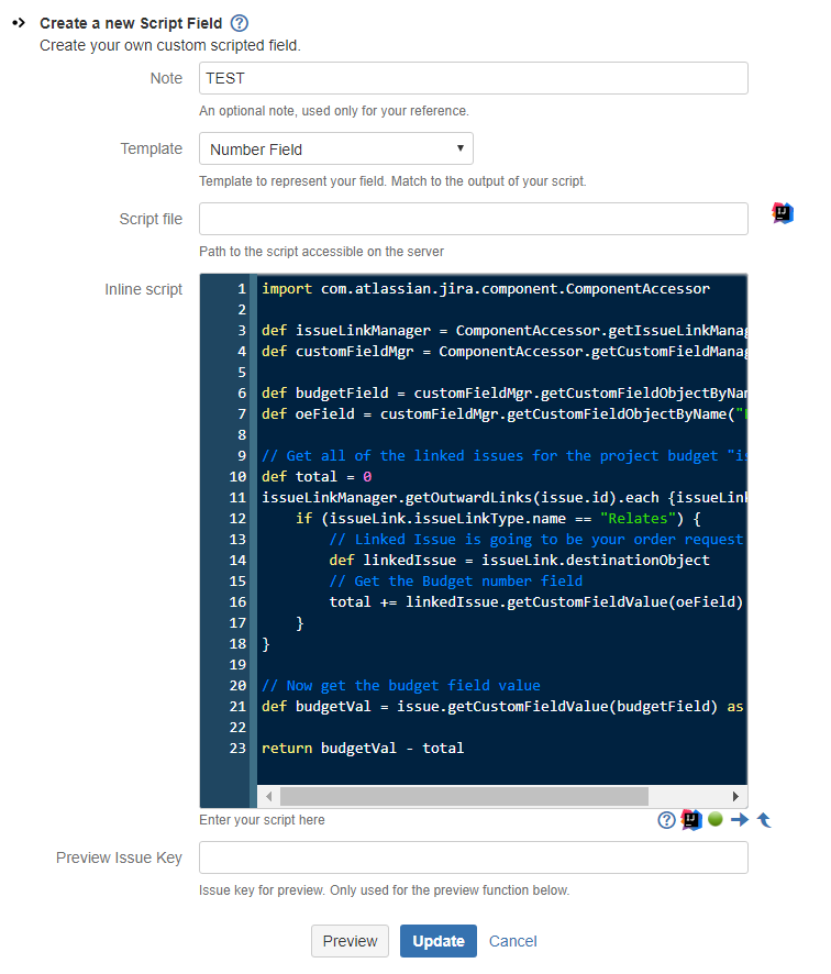

Hey @Tarun Sapra here it is. This has been a very illusive request. The scenario is that I need to script a rolling budget field.
I have an issue type "Project Budget". This issue type has a "Budget" number field and a scripted "Remaining Budget" field.
There is another issue type called "Order Request" which contains a scripted "Expense" field.
These to issue types are linked using the "Related" link type.
I need to have the "Expense" from all of the order request issues that are linked to the project budget issue subtracted from the "Budget" field and return the "Remaining Budget" in the project budget issue.

The setup for my field is:
If you want to let me know what issues you are having then I am happy to try to help you through them.
Steve

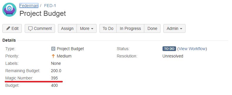

Just a quick update, here is a screenshot of it working on a basic test project. The issue that has the expense has a value of 5.

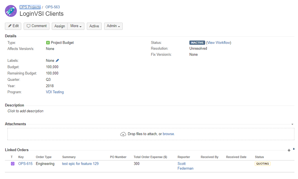

Hey Steve, Thank you for that. Its returning the same number thats in the budget field.
Here is the error im seeing in the log.

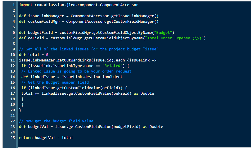

I have updated the script to be a bit more robust. When we were getting the expense field we weren't checking to see if it existed before we were adding it ;-)
def issueLinkManager = ComponentAccessor.getIssueLinkManager()
def customFieldMgr = ComponentAccessor.getCustomFieldManager()
def budgetField = customFieldMgr.getCustomFieldObjectByName("Budget")
def oeField = customFieldMgr.getCustomFieldObjectByName("Expense")
// Get all of the linked issues for the project budget "issue"
def total = 0
issueLinkManager.getOutwardLinks(issue.id).each {issueLink ->
if (issueLink.issueLinkType.name == "Relates") {
// Linked Issue is going to be your order request
def linkedIssue = issueLink.destinationObject
// Get the Budget number field
if (linkedIssue.getCustomFieldValue(oeField)) {
total += linkedIssue.getCustomFieldValue(oeField) as Double
// Now get the budget field value
def budgetVal = issue.getCustomFieldValue(budgetField) as Double
return budgetVal - total
This could explain your issue. Please use this script and run again :-)

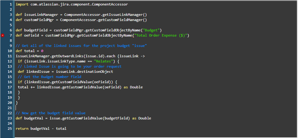

I also just realized you are pulling expense not Total Order Expense ($). Will that make a difference? The Expense field is on the the subtask of the order request.
That will make a big difference, in my test setup I called the field “Expense” for simplicity’s sake. I can see from your given examples that you want to use “Total Order Expense ($)” :-)
If i use that field the remaining budget field disappears and i get this error:
Time (on server): Wed Dec 13 2017 11:04:31 GMT-0600 (Central Standard Time)
The following log information was produced by this execution. Use statements like:log.info("...") to record logging information.
2017-12-13 10:04:31,987 ERROR [customfield.GroovyCustomField]: *************************************************************************************
Script field failed on issue: OPS-563, field: Remaining Budget
org.codehaus.groovy.control.MultipleCompilationErrorsException: startup failed:
Script171.groovy: 7: illegal string body character after dollar sign;
solution: either escape a literal dollar sign "\$5" or bracket the value expression "${5}" @ line 7, column 56.
Mgr.getCustomFieldObjectByName("Total Or
1 error
i just realized i needed to add the slash before the $. I did this and the remaining budget field cam back but it is still showing the same number as the budget itself. and im still returning this error

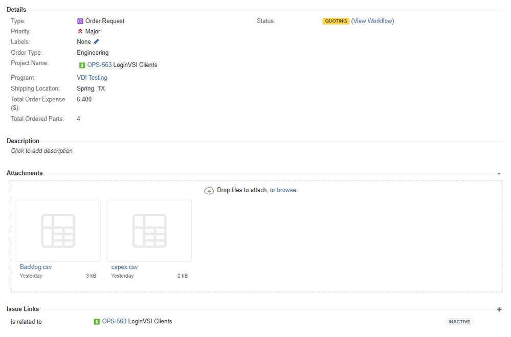

There are two things here that don't quite line up. In your error, it states:
Script field failed on issue: OPS-616
The error in your screenshot the parent issue is OPS-563 and the linked order is OPS-615. This would indicate that this is for another issue.
The fact that a number is being returned for Remaining Budget, suggests that the script is running fine, but that it is not picking up the linked order. Is there a way to confirm the link type of the linked order? This does not look like a standard JIRA link.
yes i was just looking at it and realized the outward link type is "is related to" so i changed that and im no longer throwing errors but i am still returning the same value as the budget field.

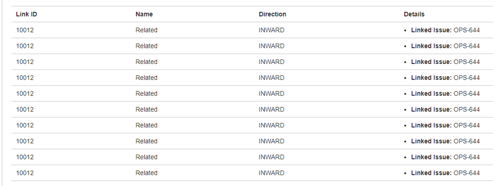

I have written a script that will take an audit of all of the linked issues on a given issue. This will allow us to confirm that the link definitely exists in an expected state.
Please run the script below in you Script Console and send me back a screenshot of the output. The expected output is a list of all of the links for the issue with ID OPS-563 which is the project budget from your last screenshot.

So i ran the script and got an error
2017-12-14 09:11:57,626 WARN [common.UserScriptEndpoint]: Script console script failed: java.lang.NullPointerException: Cannot get property 'id' on null object at Script34.run(Script34.groovy:11)
Hi Scott,
Apologies for the late reply, this is my goof. I told you to run it as-is but then I didn't change the issue key (faceplam).
You need to update this line:
def issue = issueMgr.getIssueObject("FED-1") //<-- Change this to match the issue key you want to check on...Change "FED-1" to "OPS-563"
Thanks :$
so the interesting thing is now its returning the budget number in the remaining budget field. Not showing the actual remaining budget.
Q1: Did you run the script in the script console? What was the output?
Q2: "so the interesting thing is now its returning the budget number in the remaining budget field" - Have you made any amendments to the script?
Hi Scott,
That would explain the issue. The link name isn't "Relates" as we have in the script. It is "Related".

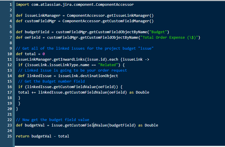

The reason that is not happening is because in the script I provided we are only looking at outward links. In the script output that you attached on the 20th of December you only appear to have "Inward" links on the issue. If you want to check inward and outward links you need to update the script to reflect this...
issueLinkManager.getOutwardLinks(issue.id).each {issueLink ->You can use getInwardLinks instead of getOutwardLinks if you just want to check inward links.

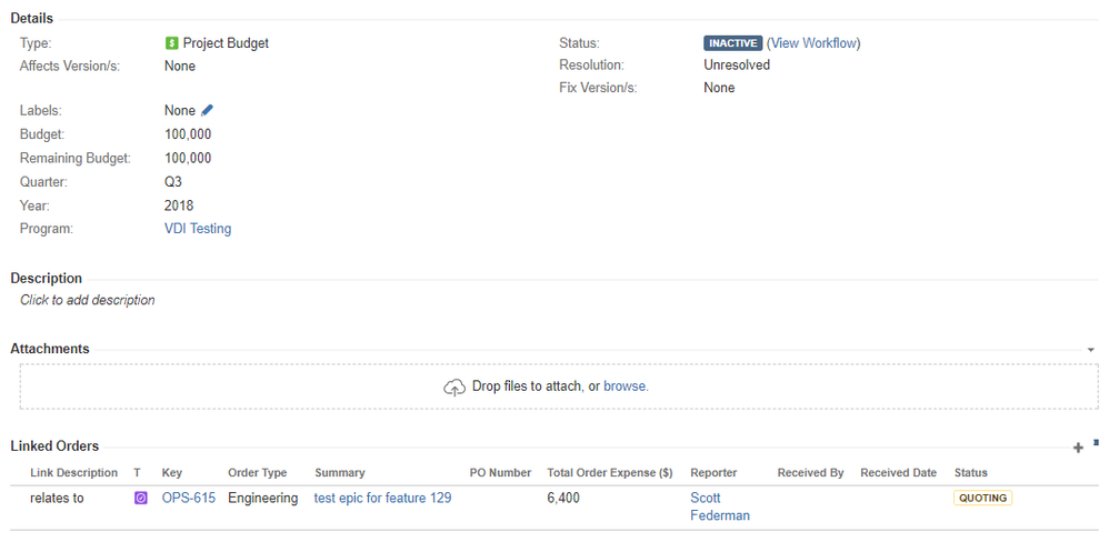

Hey Stephen, welcome back. Hope you had a great holiday and vacation.
SO i looked at that as well as the result did show inward linking, however the script itself says its looking for outward just as you suggested.
Absolutely, that's my point. I didn't realise before that we were dealing with inward links. Do you get the expected result if you switch the script to look for inward links??

We have had a continuing theme that we can’t seem to get the subtraction to work. You always appear to end up with the “Remaining Budget” matching the “Budget”. I’ve done some investigation on this and this is happening because we are looking at the wrong side of the budget for the expense value.
In order to solve this issue, if you switch to looking for inward links, then you need to change this line:
To this line:
def linkedIssue = issueLink.sourceObject
I hope this helps clear up your issue.

def total = 0
if (issueLink.issueLinkType.name == "Related") {
