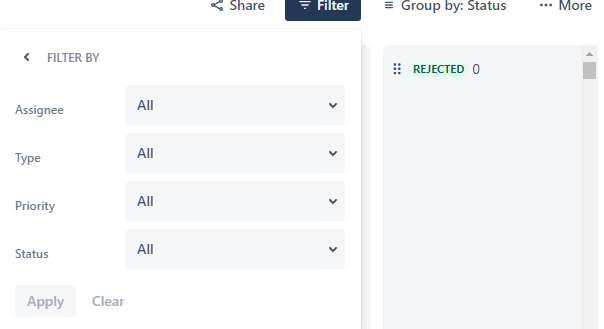

I would first check no quick-filters are applied, then identify two issues - one that appears and one that should, and compare them for differences.  Issue type?  Assignee?  Custom fields?
Gregory James
February 16, 2023
Nic Brough -Adaptavist-
February 16, 2023
Ok, good, no quick filters.  Have you managed to find an issue that should be on the board, but is not?
