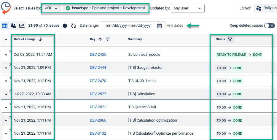

If you are open to trying add-ons, check out Issue History for Jira developed by my team. You can filter by specific transition like "to Completed status" and create a report like the one below. You will get status transition history for every epic.

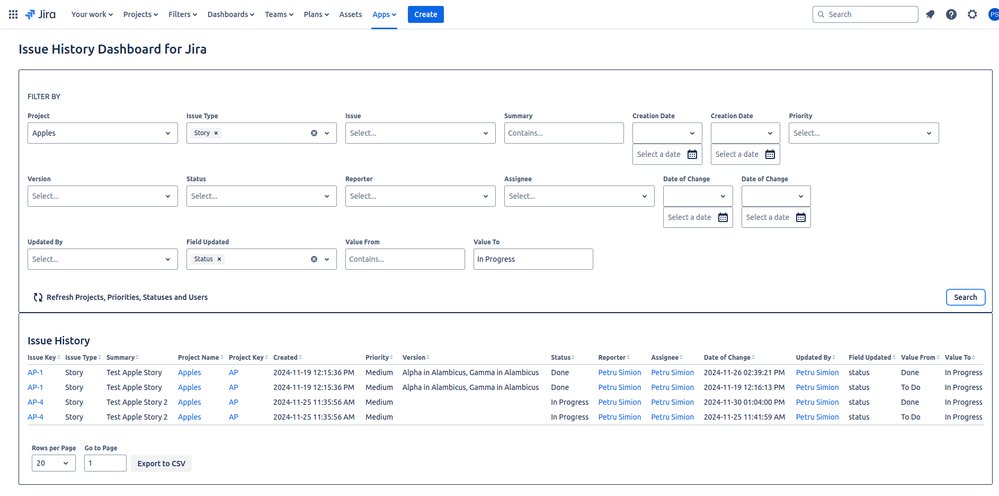

Hi @Dominga Savino ,
Then you write a JQL script to retrieve all issues that match your desired value for the created scripted field.
You filter for Issue Type- Epic, Updated Field - status and Value To - Completed.
If by any chance you are using Resolution to determine the completion, you search for Updated Field - Resolution instead.
The example below is using a Story and status but you can use Epic instead.
Petru
