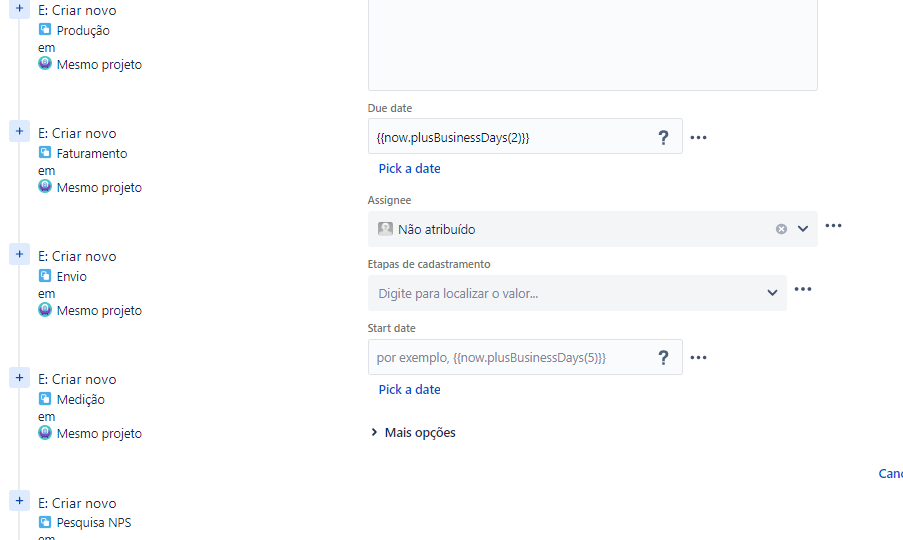

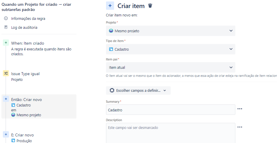

I programed a rule to creat a subtasks when a creat a task and automatically edit the start date of subtasks but the field not update, i try many forms but the rule fail and present the error:
"Unknown fields defined during creation. They may be unavailable for the project/type. Check the custom field configuration. Ignored fields –
Start date (customfield_10015)"
The most strange is when i use the same rules in deadline its worked

@Deepanshu Natani I don't believe that's it because I've already changed this field in other rules, the problem is when I associate tasks and subtasks
Trudy Claspill
September 2, 2021
Please show us all the details of your automation rule.
Douglas Oliveira
September 2, 2021
Douglas Oliveira
September 2, 2021
does matter wich formate i use doesn't work
