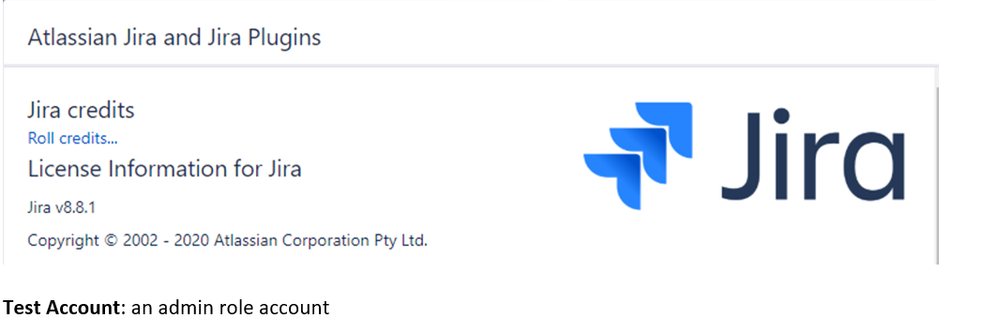

JIRA software version: 8.8.1

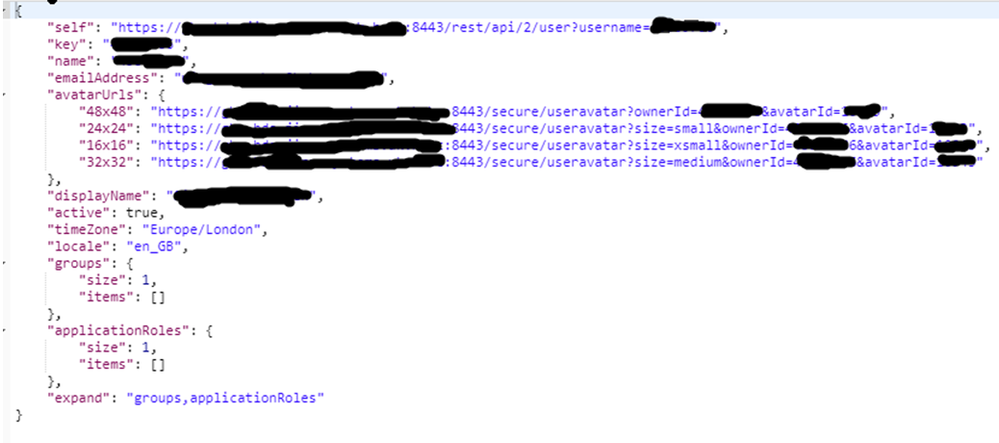

Is the username an existing user?
the response /rest/api/2/user?key=xxx}'s response does not contain a field "accountId". suggest it does not
double check the name value.
