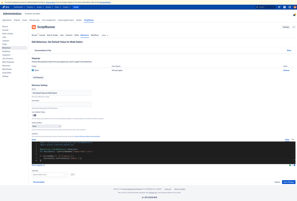

Below is a screenshot of the Behaviour configuration:-
Below is a screenshot of the workflow that I am testing with:-
I am also including a couple of these screenshots for your reference:-

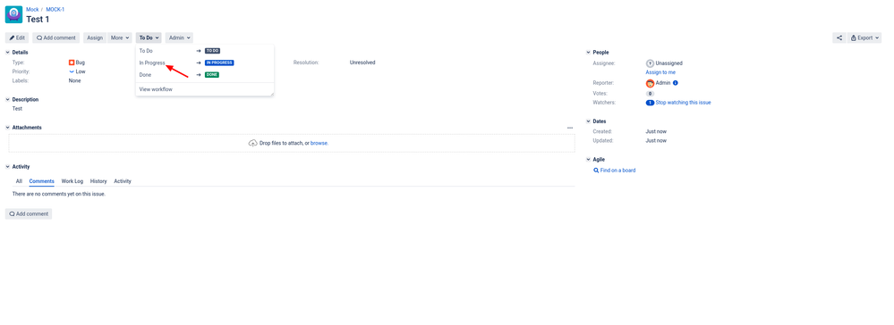

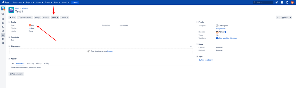

1. First, I create a sample issue of Bug-type as shown in the image below:-
2. Next, I transition the issue to In Progress, as shown in the image below:-

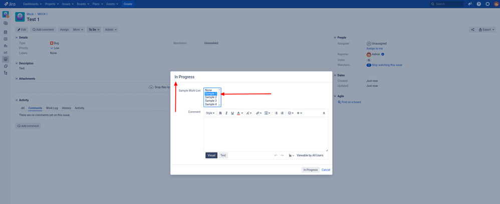

3. When the transition takes place, the dialog pops up, and in it, the Multi-Select List has been set to the default value Sample 1, as expected.

The screenshot that I have shared in my previous comment explicitly shows where the Behaviour Initialiser is located, i.e.:-
In the screenshot above, I have added the end code after I have determined what is the action name.
