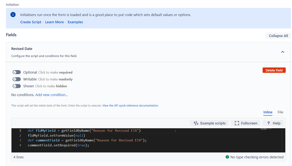

We have a requirement when "revised date" field is changed the user has be to update "Reason for revised ETA"
I'm using Script runner's Behaviours to achieve.
I have added the field " revised date" in behahour and added server side script as follows:
I assume you just added the code as "initializer", not actually added it as a script to the added field?
I.e. initializer loads on screen load, only once; but the code added onto a field loads "on change", more or less
Oh right, also reproduced.. my bad, totally forgot they changed that at some point.
Found this that explains it: https://assist.adaptavist.com/browse/SRJIRA-3418?focusedId=478183&page=com.atlassian.jira.plugin.system.issuetabpanels:comment-tabpanel#comment-478183
The workaround there is worth a try. Works locally at least using

On create, underlyingIssue is null, so it can be used as a check whether the issue exists or not. Though it's kind of dirty Adaptavist doesn't appear to think of this as a bug, which I disagree with, until there is a checkbox to ensure it only runs on field changed events.
What do you mean by user input? That's just a test value I used so I can see it when the behaviour works out the condition.
I would guess you should reuse what you had
def fldMyField = getFieldByName("Reason for Revised ETA")
fldMyField.setFormValue(null)
fldMyField.setRequired(true);
Hi Radek,
That doesn't work as well.
After some googling and little modifications the below code works fine for me.
Thank you for your time Radek. Really approceiate it.
