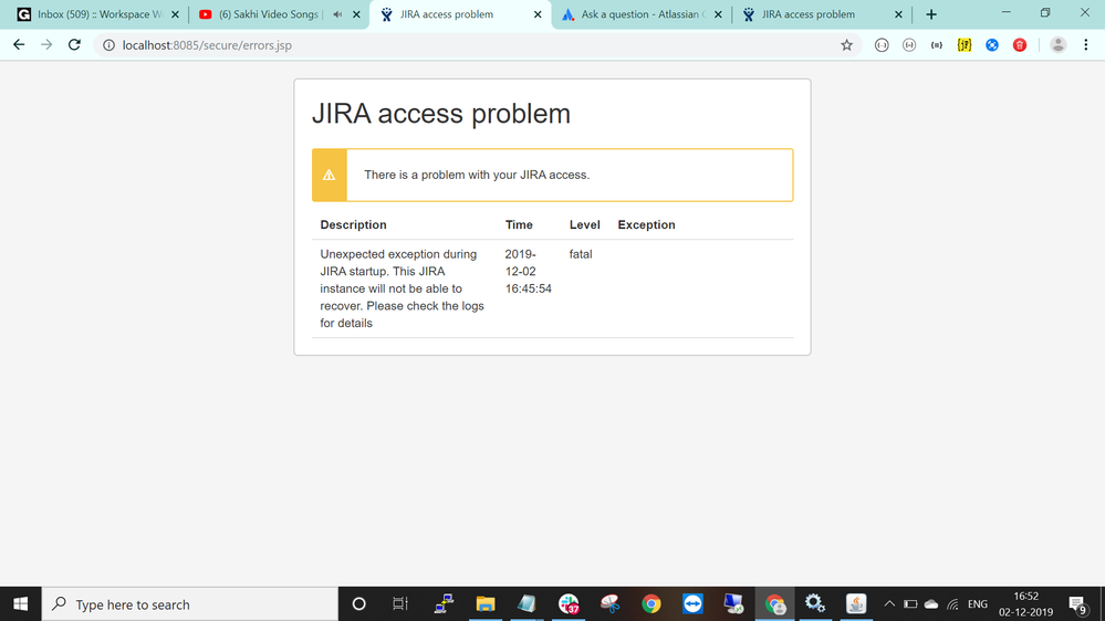

Hi team,
After upgrading jira 6.4.6 with jira 7.0 not able to start jira.
getting error like this.

2019-12-02 16:45:54,573 localhost-startStop-1 ERROR [c.a.jira.startup.LauncherContextListener] Unable to start JIRA.
java.lang.IllegalStateException: You cannot perform an import with an invalid validation result. Errors: {}
Error Messages: [This JIRA installation has already been set up. Please perform an XML restore instead of an import during setup.]

Hi @Mahendar D ,
the error message says the instance is already setup :
Can you try restarting Jira ? If you get access to the interface, you should then try to restore your XML backup from the Administration menu.
Let me know if this helps,
--Alexis
