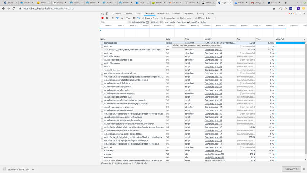

yes, all request are pointing right, eg:
https://jira.cubecloud.pl/rest/api/1.0/shortcuts/74002/995cd2eaa79e6543b58f399fb66e5383/shortcuts.js

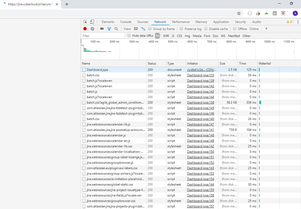

After login (but browser is still waiting):

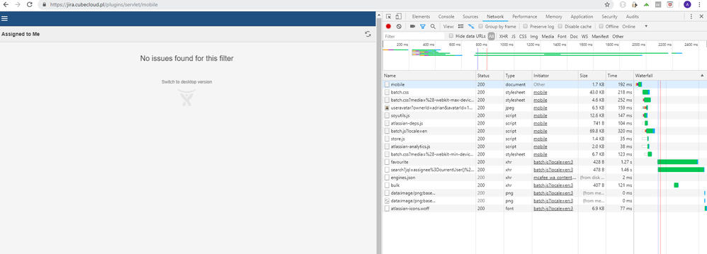

other than dashboard url:

So the browser is actually still waiting for something when you get the blank page? Have you tried waiting until it times out? Does that give a line with an error code in the network monitor?

after some time browser stop loading and I got net::ERR_INCOMPLETE_CHUNKED_ENCODING::
