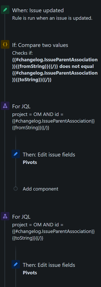

I am glad that worked for you, and...something I note in your rule:
The rule appears to use two JQL branches on the previous and current parent, and then edits each specific issue's Pivots field.
Branches that could be on more than one thing (e.g., JQL) run asynchronously and in parallel.  There is no guarantee when the processing of the branch will finish, up to the last step of the rule.
If that image is your entire rule, no problem!  However, if your rule has more logic after those branches AND which depends on the edits being completed, the rule may not work as you expect.
Ryan
March 13, 2023

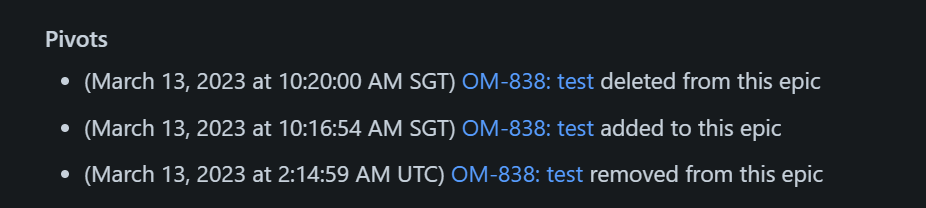

ah ok, that's good to know on how jql handles asyncrhnous. yea it's fine in this case, cause the order isn't as important. i'm trying to build my own logging of pivots that occurred in the lifetime of the epic by logging that info back to it's previous and new parent
