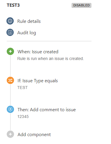

It's working sligtly different. Trigger action can't be changed, it's "Issue Created", "Issue Changed", "Issue Transitioned" adn so on.. without IF's.
BUT you can use IF as filter right after trigger event, and to check, that created issue (for example) was from required project, or has required issue type, component, summary and so on.
Screen in my answer above - it's example, how it works.
