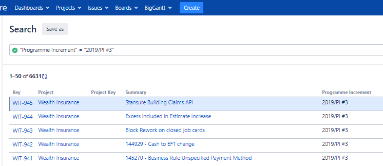

having the same problem trying to filter Rest API results using Jira custom field but getting the below error
{"errorMessages":["Error in the JQL Query: The quoted string '2019/PI ' has not been completed. (line 1, character 35)"],"errors":{}}
https://tools.standardbank.co.za/jira/rest/api/2/search?jql=project=ard%20and%20customfield_18625=%222019/PI%20#3%22
Programme Increment = customfield_18625

Your issue looks like a problem with the "/" - have you escaped it correctly?
Mabutho_Mncube November 5, 2019
Hi @Warren
it's correct I believe I just copied and paste it, it does return the results on jira as you could see in my screen print above.
question is : it is possible to filter data using customfield??
Warren
November 5, 2019
Hi @Mabutho_Mncube
Yes it is definitely possible to filter on customfields. I've been playing around with your string and the # seems to be causing the issue.
For your API call, you need to change these :
  • Replace customfield_18625 with "Programme Increment" as per your screenshot.
  • Escape the # character with %23.
If that doesn't work, remove the # character and change = to ~
thanks @Warren
you r a hero man "Escape the # character with %23" just worked fine
