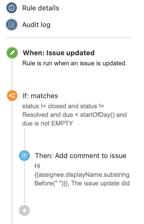

I'm having a struggle in doing the following:
Goal:
If an issue is just updated and is not resolve and closed and due date is in the past add a comment.
Issue:
  • I have this kinda working but only triggers if the due date is changed
    • but I'd like it to trigger whenever the issue is updated and it meets the overdue criteria
  • It shows in the audit log that the rule didn't run
  • what am I doing wrong??
JQL
  • status != closed and status != Resolved and due < startOfDay() and due is not EMPTY
Also,
  • I have "Prevent duplicates by only adding this comment once to a particular issue." disabled.
Here's a snapshot of the automation.
John Funk
May 18, 2023
Hi Gavin,
What did you change that should have updated the issue? And what that change done directly to the issue? Or was it a change to the issue as the result of another rule running that updated the issue?
Gavin
May 18, 2023
Thanks for the response.
> I added a comment
> yes
> no
John Funk
May 18, 2023
So, that tells me that adding a comment to an issue does amount to "updating" it in Jira's eyes. You would need a second rule that handles those - you should be able to simply copy your existing rule and change the Trigger to Comment added instead of Issue Updated.
Gavin
May 18, 2023
So does that mean that comment added isn't an issue update?  If so why does the "updated" field show the last comment that was add time time stamp?
John Funk
May 18, 2023
I suspect the automation rule is triggering on something else and not the Updated date itself then. But I can't answer that or tell you what constitutes an issue being "updated". I  can just a solution based on the observances you describe.
Gavin
May 18, 2023
yeah that did work! just a little confusing what is constituted as an update.  Guess there is a distinction between comment and issue update.
Like John Funk likes this
John Funk
May 18, 2023
Yeah, to me adding a comment should constitute an update as well. But glad that worked for you!
