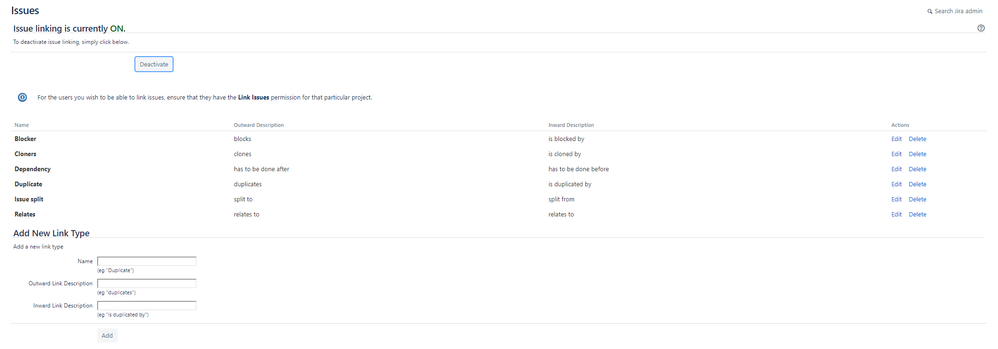

Hi Natasha,
These other link types are available by default. However it is possible that in your site, these have been customized in some way to remove these 'is blocked by' reciprocal link names. You can see more on how issue linking is configured in your site under Configuring issue linking. Jira's JQL can only search on link types that exist in your Jira site.
Thanks Natasha,
I can see that you have many of the default link types, and a pair of custom ones. You should be able to use the JQL syntax of
issueLinkType in (blocks, "is blocked by")
to find the issues that have either link type description (inward or outward description of links under the name blocker). Note that quotes are required for any inward/outward description that contain spaces. Also you can't use the Name of the link to search (which is Blocker in your case), but instead you have to use the description of 'blocks' or 'is blocked by'.

Error msg "Could not find any issue link type having either inward or outward description: additional parent of. Remove argument to search all link types. Available links are: [additional parent of , additional child of, Cloned from, Cloned to, duplicates, is duplicated by, is Epic of, has Epic, parent of, child of, Post-Mortem, Incident, depends on (deprecated), is depended on by (deprecated), causes, is caused by, relates to]"
Is anyone else experiencing this? How do we fix this?
Thank you.
i had the same issue and the solve was to make sure the text is exactly the same. In your instance do you call it "additional parent of" or just "parent of". we do the latter and it worked fine.
