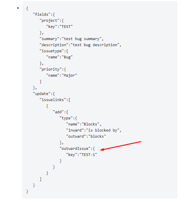

HI. Check this KB https://confluence.atlassian.com/jirakb/how-to-use-rest-api-to-add-issue-links-in-jira-issues-939932271.html
maybe you missed this block
