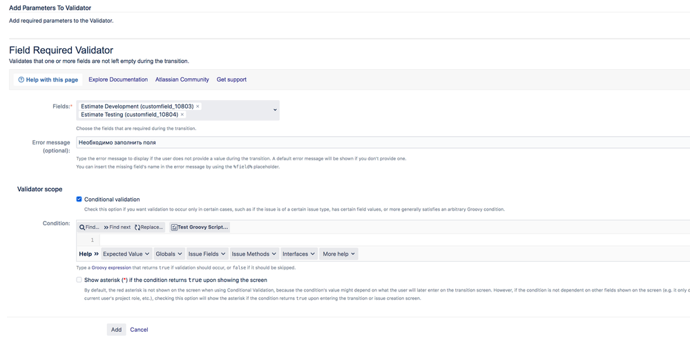

help me please with validation on workflow (create issues)
jmwe conditions
required fileds value must be not empty and !=0
issue.get("customfield_10803")!=0 && issue.get("customfield_10804")!=0
this one should works but it`s not
Hi @vsoldatova ,
are these Number custom fields? And are you using this script in a "Scripted (Groovy) Validator"?
You need to create a Scripted (Groovy) Validator, not a Field Required Validator. Conditional Validation will simply skip validation if the script returns false.
Then the script of the Scripted (Groovy) Validator should be:
issue.get("customfield_10803") && issue.get("customfield_10803") !=0 && issue.get("customfield_10804") && issue.get("customfield_10804") !=0
