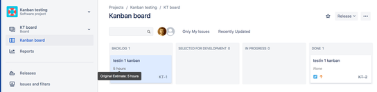

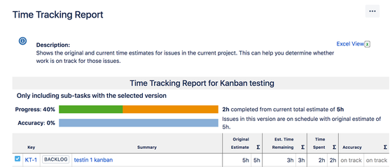

Navigate to project settings > Screens > add the time tracking field to your Kanban issues. You will be able to set estimations with the Original Estimate field to your issues, reflecting its progress in the time tracking report of the Kanban board:
Screen Shot 2019-06-04 at 17.45.56.pngScreen Shot 2019-06-04 at 17.46.17.png
I believe this feature always worked properly with Kanban projects. That been said, can you please give us more details on how do you expect it to work so we can confirm we are on the same page here? Is there any feature in Kanban that you have identified any issues with Time Tracking?

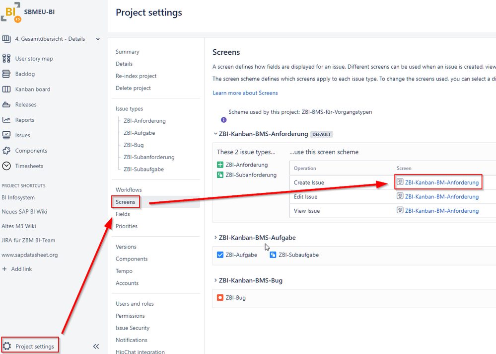

Stephan Schaumburg-Lippe June 5, 2019
It worked! Thx's a lot.
It took me a while to figure out where I have to add the field, so I added a screenshot to make it clear.
BR, Stephan
